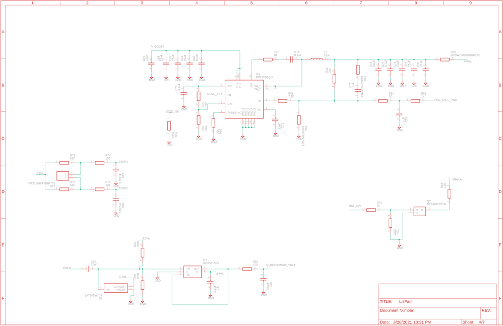

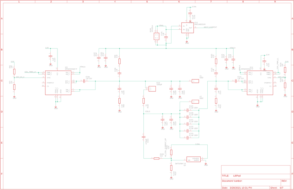

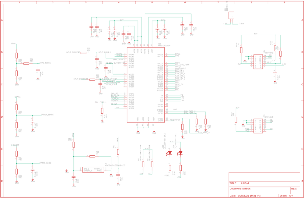

I have designed a board with the MWCT1013 based on the WCT-15W1CFFPD reference design. When I try to charge a phone using my board the MWCT1013 successfully communicates with the Qi receiver but after a few seconds will stop charging and indicate that there is a fault with the LEDs. I cannot determine what fault is being triggered in the device. What could cause these issues? What are some debug steps that I should use to investigate this issue?
Some things that I have tried:
Powering the board externally from a clean supply: does not fix the issue
Disconnecting the Temperature monitoring resistor: does not fix the issue
Calibrating the ADC: Does not fix the issue
Reviewing my schematic vs the reference schematic: The big differences are the Half-bridge FETs and the current sense resistor. What are the Half-bridge FETs on the reference design?
The coil that I am using is the 595-WTSC-6R3K-A11-ND
Here is my schematic:
Thank you for your help!

JozefKozon
Dear Michael,
we have a FreeMASTER Run-Time Debugging Tool and a debugging user guide. You can download the Tool from this link at a very bottom of the page. Please find the debugging user guide attached.
I have applied for the WCT-15W1CFFPD hardware design files. As soon as I will receive them I will let you know what Half-bridge FETs and transmission coil is used in reference design.

mgwalker95
Hi Jozef,
I have followed the debug guide and have not found the issue. Are there any variables I can read in the code to see what fault is triggered?
Have you found the part numbers for the devices?

JozefKozon
Hi Michael,
please find a Transmitter Library User’s Guide attached, where errors are also described. I am still waiting for the design files. The representatives asked for the details I shared with you. I am not sure if they are allowed to share the design files for a hobby project. I have sent them your answer and I am waiting for their reply.
