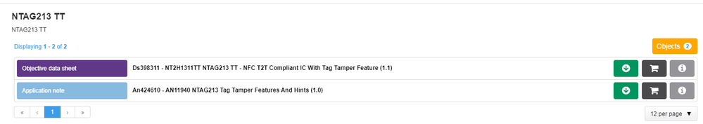

As I know, the TapLinX – Java based SDK supports NTAG 213 Tag Tamper. Please kindly refer to https://www.mifare.net/en/products/tools/taplinx/ for details.
and you may find the data sheet as well as app notes for this part in our docstore as shown below.
Please also note these docs require NDA signed at first, so you have to contact your local Disty for further assistance on this, or create a private ticket for the NDA.
Please kindly refer to the following links for more details.
https://www.nxp.com/support/sample-and-buy/distributor-network:DISTRIBUTORS
https://community.nxp.com/t5/Using-Our-Community-Knowledge/How-to-submit-a-new-question-for-NXP-Supp...
I also attached the guide for docstore request here, hope that helps,
