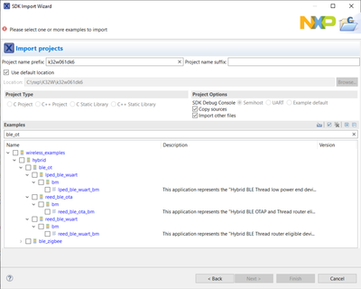

Hello NXP Community,
I am newbie to the Thread Protocol, as a beginner I started with thread understanding and for hands-on I tried downloading the MCUxpresso SDK for FRDM-KW41Z. I was able to build the examples and flash them on the development board.
Now I have to use the K32W in our project so I am exploring the K32W related resources.
As a first step I have downloaded the mcuxpresso sdk for the K32W and imported the examples for the same what I can see  is-
Seems like only demos are available for bare metal.
So the question is-
1. Is there any FreeRTOS based demo available for K32W preferably REED+BLE with thread not openthread?
2. Is there any FreeRTOS based demo available for K32W preferably REED+BLE with openthread ?
Next please share the resources which will help in getting understanding.
Thanks!!

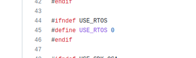

Hi @Ricardo_Zamora,
Thanks for your response.
One more query I have please guide,
https://github.com/openthread/ot-nxp
the above repo includes a RTOS based file and as well as the macro USE_RTOS so can I use -DUSE_RTOS=1 to enable the RTOS support?
or what is the way if I want to implement the FreeRTOS based REED+BLE do I need to implement it from scratch?
I haven't yet fully explored the source if you can guide it will help.
Thanks!!
2,494件の閲覧回数
Ricardo_Zamora
As you can see in ot-nxp github or in the SDK, there is no implementation using FreeRTOS. The only supported examples are the ones I mentioned in my previous reply.
Ricardo

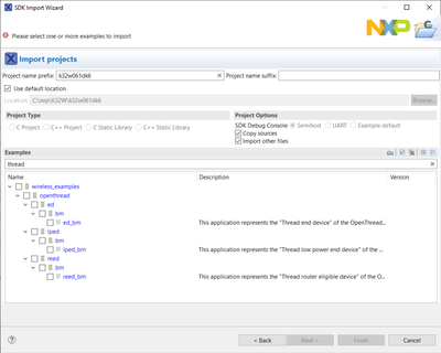

Ricardo_Zamora
Hope you are doing well. There are not FreeRTOS Thread SDK examples, the available SDK examples are these:
Ricardo
