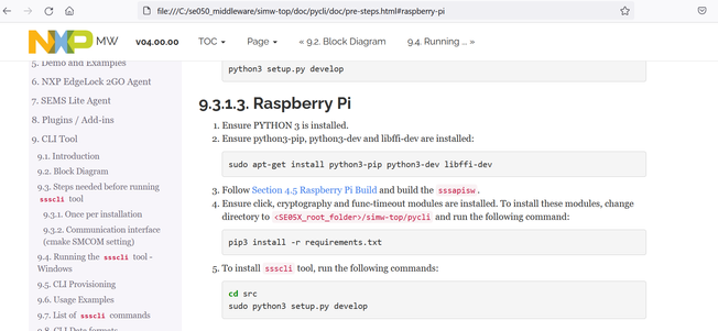

Kan_Li
Hi @jsl123 ,
The UM for MW has some details regarding install ssscli tool, Have you followed these steps?
Please kindly refer to "simw-top/doc/pycli/doc/pre-steps.html#raspberry-pi" for more details.
Hope that helps,
Kan
