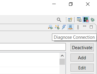

JosephAtNXP
Click this action on QCVS view.
Also, please provide the processor you are working with.

JosephAtNXP
Excuse me, I thought you were working on ARMv8 CW, it probably doesn't have that action. Double check that your
$ netparam
And
$ tgtty
Parameters are the same on both TAPs. Also, review the chapter 12 of the attached document, after being sure that they have the same settings and there are not network issues nor power issues. We can proceed through warranty, seems likely to be a singularity that can be handled filling this form.

JosephAtNXP
Thank you for your interest in NXP Semiconductor products,
Do you happen to switch TAPs between TIPs? Looking to avoid TIP continuity and 10-pin misplacements.
Also, what are the outputs to diagnose connection test?
