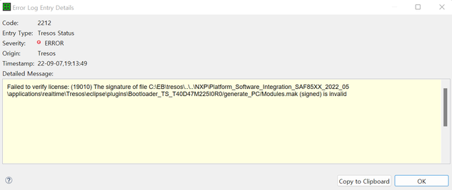

As title says,
Code generation fail with below error log when .mak file has been modified.
Any solution for resolving this?
389 Views
cuongnguyenphu
Is there any change from your site to get this error? As the error said that module.mak fail in verify license.
I think you should uninstall then reinstall this package
