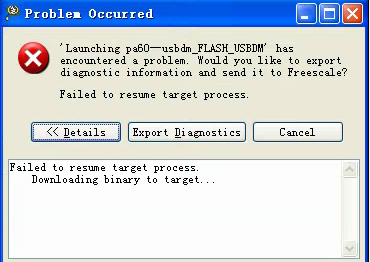

I meet a question when i use cw10.5 to debug pa60 through USBDM
program can be download,but the chip can't be debug.
can you try it?

hi pgo,
is this a bug?how to resolve the question?

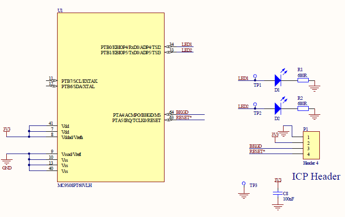

    wangbaode
    hi pgo,
    my schematic is also in attachement.

    Senior Contributor V
    Hi Wang,
    According to the schematic you provided you haven't connected all the power supply and ground connections.  These are necessary for reliable (or at all) operation.  This is especially true during programming when there are current spikes.
    For reference I have attached the test circuit I use.
    If you refer to the data sheet (2.2.1 Power (VDD, VSS)) it also recommends additional power supply bypass which I have not included in the test circuit.

    Hi pgo,
    according to your response,I try it again.But I'm failed again. USBDM programmer can program application into PA60.
    but it can't be debugged through USBDM. is there other reasons ,for example,my project or codewarrior?

    wangbaode
    Dear pgo,
    PA60 can be debugged through USB Multilink,but still can't be debug through USBDM.
    2,888 Views
    wangbaode
    Dear pgo,
    It work well to use the stand-alone programmer to program the s19 file to the target.just can't be debug.
