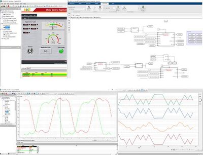

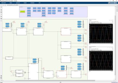

The toolbox provides examples for both 3-shunt PMSM and BLDC motor control applications. Each of them has a detailed description of the hardware setup and an associated FreeMASTER project which can be used for control and data visualization.

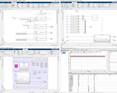

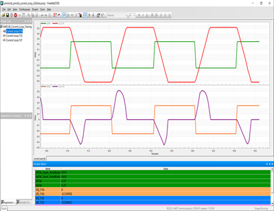

  • FreeMASTER Integration
We provide several Simulink example models and associated FreeMASTER projects to demonstrate how our toolbox interacts with the real-time data visualization tool and how it can be used for tuning embedded software applications.

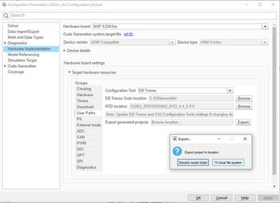

  • S32Design Studio Integration
We provide a simple mechanism to let users the opportunity to export the code generated from Simulink and import it directly into S32Design Studio. This functionality can be useful if the model needs to be integrated into an already existing project or for debugging purposes.
