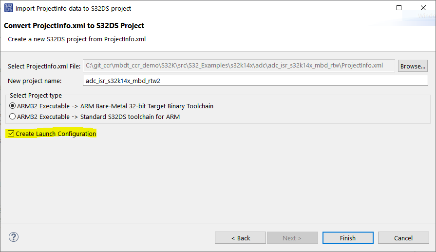

4) It will create a complete launch configuration if you check the box as in the image below (even with the GDB Client settings); but indeed there seems to be an issue with the S32DS when importing a project for S32K11x (for S32K14x seems to be working fine). We will look into this and get back with a patch most probably.
