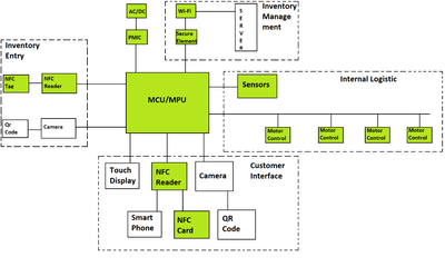

We have a control by sections managed by a main controller, we have the following sections:
  • Inventory reception: It consists of a reader of an NFC tag or a QR code to read the product and be able to move it to its corresponding storage section
  • Inventory management: Connection to the cloud to be monitoring in real time to use algorithms handling orders, inputs and outputs
  • Internal logistics: It consists of motor control by section for the mobility and arrangement of articles. It uses sensors for safety in mobility and accident prevention.
  • Customer interface: NFC or QR code reader for package pickup reading indicator, touch screen to display data and customer confirmation.
Block Diagram

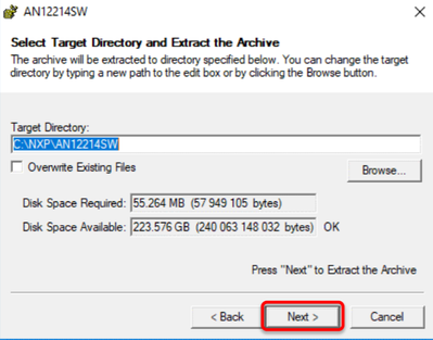

  • Download the software AN12214SW
  • Unzip and install

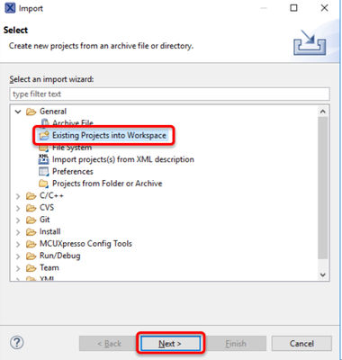

  • Open MCUXpresso
  • Import project

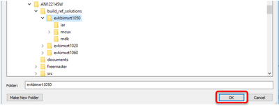

  • Look in the AN12214SW software installation folder
  • Click on finish

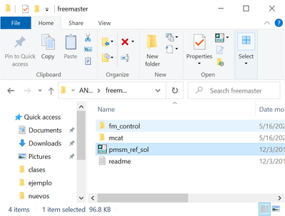

  • Open the freemaster folder in the software installation folder and open the pmsm_ref_sol

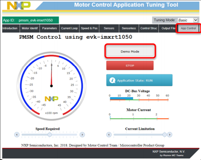

  • Change mode expert a basic
  • Click on app control and run
