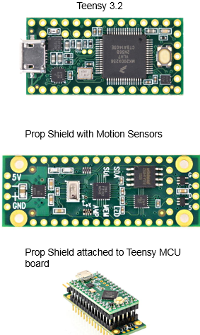

Features
The Teensy Prop Shield is an add-on sensor shield board for the Teensy 3.1 which is an USB based microcontroller development platform. The Teensy 3.1 has a 32 bit ARM Cortex M4 processor from NXP -MK20DX256. The board can be programmed using Arduino IDE + Teensyduino plugin.
The prop shield consists of the following devices:
  • Motion Sensors - Allows motion interactive light & sound.
  • Audio Amplifier - Clear quality audio output to a small speaker.
  • Fast LED Driver - Drive APA102 / Dotstar LEDs for colorful lighting with rapid response.
  • Flash Memory - 8 Mbyte storage for images, sound clips, and data logging\
Featured NXP products
  • FXOS8700CQ - 6 Axis Linear Accelerometer & Magnetometer
  • FXAS21002C   - 3 Axis Digital Angular Rate Gyroscope
  • MPL3115A2     - Precision Pressure/Altitude & Temperature sensor
  • MK20DX256   - 32 bit ARM Cortex M4 processor

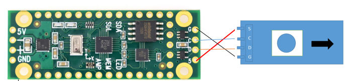

Demo Setup:
Wiring[1] :
Software:
After setup, Download Arduino IDE and Teensyduino add on and follow the instructions as defined in the page below
http://www.pjrc.com/teensy/td_download.html
Note: Arduino version used for this demo:  1.6.8.
Run the “Teensy_RGB_Led_Strip.ino” sketch attached.
