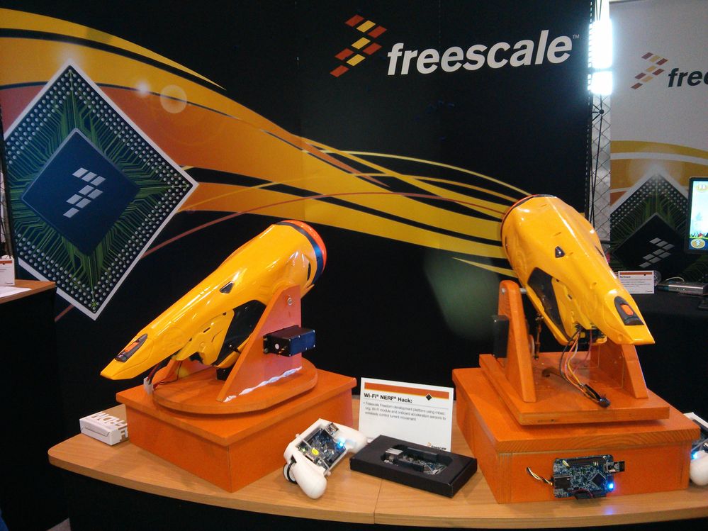

This was a super fun project to work on and is popular around the office and on the road.  Now I have two of these for a truly amazing barrage of Nerf darts!  It's also always a lot of fun to tear things down and the Nerf gun had some cool plastic work and the shooting mechanism is more simple than what I originally guess.  But I digress, this post is about how you can build one of these yourself.  Please leave any questions or comments in the section below and I will try to answer and make refinements to this guide as we go.

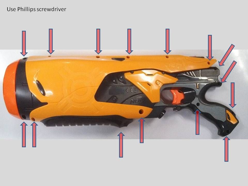

There is no shortage of screws with this Nerf Gun.  So get out your Phillips screwdriver and go to town.

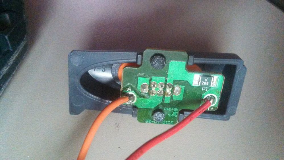

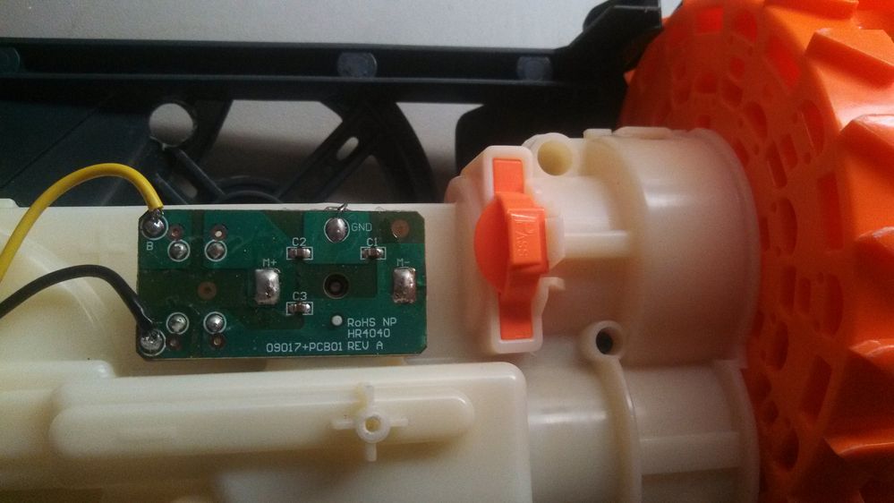

There are two electrical systems in the Nerf that we are going to tap into.  One is the power switch and the other is the electrical trigger.
This is the electrical trigger.  The trigger goes to our relay, which is either on or off.  We did try at first to use a 7.2V R/C car battery, but the Nerf draws too much power and didn't fire.  Going up to a 11.1V LiPo fixed that right up.
This is the power switch.

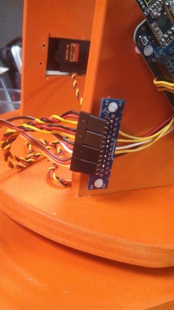

In Nerfinator 1.0 everything was hardwired together, which prevented us from completely pulling the Nerf from the base and made repairs difficult to say the least.  Nerfinator 2.0 we put this handy connector which allowed us to completely and easily remove the Nerf from the base.  Shipping this thing around the country will take a toll on it!  On that subject, Nerf 1.0, stopped cycling to the next position for us at the Austin Mini Maker Faire.  After a through inspection of the operational mechanics inside the Nerf (really cool BTW) it was a little bitty spring that was causing the piston not to fully retract.  We replaced the spring with 1/2 a ballpoint pin spring and to our surprise it all worked again.
