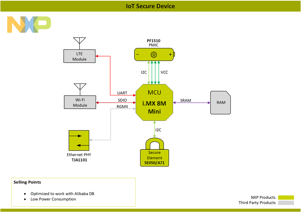

Overview
With the expansion of IoT technologies, it is required to implement devices that allow a trusted environment for such technologies.
This device allows to have a secure environment thanks to the use of the A71CL Secure Element, which provides a root of trust at the IC level and chip-to-cloud security while working with IoT technologies.
Besides the A71CL, the implementation uses a i.MX 8M Mini in order to work with high performance and low power consumption.
Block Diagram
Products
Category MPU
Product URL i.MX 8M Family - Arm® Cortex®-A53, Cortex-M4, Audio, Voice, Video
Product Description The i.MX 8M family of applications processors based on Arm® Cortex®-A53 and Cortex-M4 cores provide industry-leading audio, voice and video processing for applications that scale from consumer home audio to industrial building automation and mobile computers.
Category Power Management
Product URL PF1510: Power Management Integrated Circuit (PMIC) for low power application processors
Product Description The PF1510 is a Power Management Integrated Circuit (PMIC) designed specifically for use with i.MX processors on low-power portable, smart wearable and Internet-of-Things (IoT) applications.
Category Transceiver
Product URL TJA1101: 2nd generation Ethernet PHY Transceivers - IEEE 100BASE-T1 compliant
Product Description
TJA1101 is a high-performance single port, IEEE 100BASE-T1 compliant Ethernet PHY Transceiver.
Category Secure Element
Product URL EdgeLock™ SE050: Plug & Trust Secure Element Family – Enhanced IoT security with maximum flexibility
Product Description The EdgeLock SE050 product family of Plug & Trust devices offers enhanced Common Criteria EAL 6+ based security, for unprecedented protection against the latest attack scenarios.
