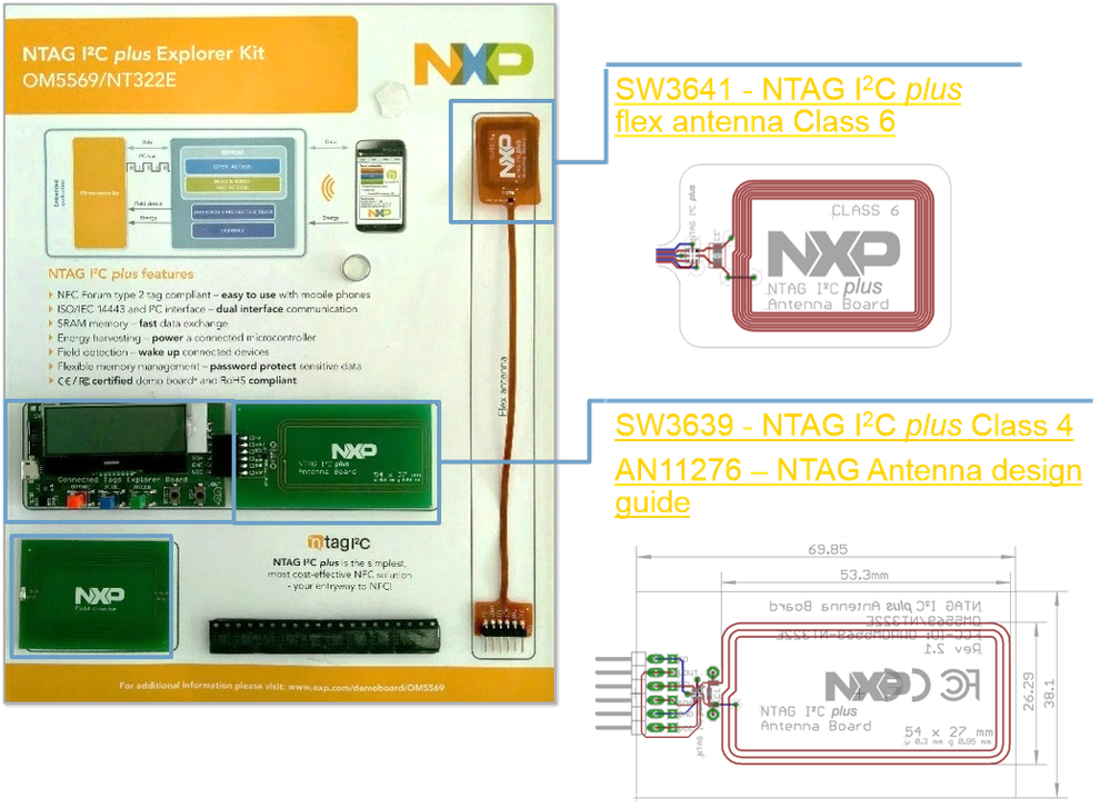

NTAG I2C plus antenna design files
The NTAG I2C plus support package includes development kits, demo apps, sample code, application notes, and, the design files of the Class 4 PCB antenna, and the Class 6 Flex antenna, which are available for direct and free download from the website. ntag psp.png These design files
include:
  • The schematics
  • The Gerbers
  • The BoM
Therefore, if you do not have any antenna size or shape constrains in your application, the easiest is to just copy & paste these reference antennas.

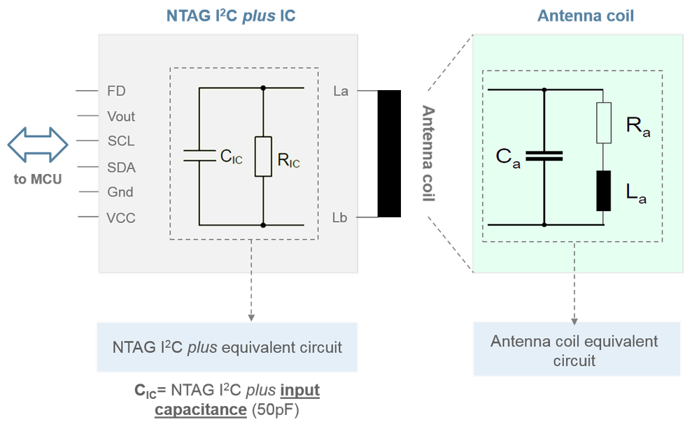

NTAG I2C plus electrical input capacitance
The NTAG I2C plus equivalent circuit can be represented with:
  • A resistor, representing its current consumption
  • And a parallel capacitor, representing the chip internal capacitance
For the NTAG I2C plus, this capacitance is 50pF for both the 1k and 2k memory versions. Precisely, the chip capacitance is the most important factor for the antenna tuning.
Antenna coil electrical equivalent circuit
The antenna coil itself is a resonant circuit with an input impedance. The electrical equivalent model of the antenna coil consists of:
  • An inductance
  • A capacitance
  • And some resistive losses of the loop antenna itself.

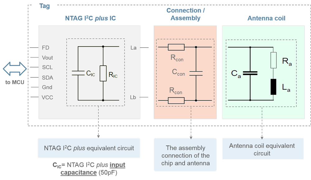

Tag with an NTAG I2C plus electrical equivalent circuit
When the NTAG I2C chip and the antenna coil are assembled, we can consider a parasitic resistance and capacitance generated by the connections between the chip and the antenna. This parasitic impedance depends on the assembly process used and the antenna material.
As a result, what we can observe in the schematic of the figure is that the NTAG I2C plus capacitance together with the parasitic connection capacitance and the antenna capacitance forms a resonance circuit with the inductance of the antenna
coil.

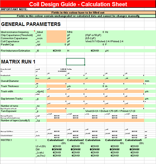

The major parameter of the antenna coil is the inductance. This inductance can be estimated based on geometrical parameters and the material properties such as:
  • The diameter for a round antenna or the overall length and width for a rectangular shape.
  • The track width
  • The gap between track
  • The thickness
  • And the number of turns
To avoid cumbersome formulas, NXP offers you an Excel-based coil calculation tool to estimate the inductance of rectangular and circular antennas. This tool uses some parameters related to the material used and the antenna dimensions. And with it, it estimates the antenna inductance for you. Typically, the coil design steps include:
  • An estimation of the electrical parameters, like the operating frequency and the chip capacitance
  • The definition of the target inductance, we define the dimensions, the track width, the gap between track, the thickness, etc that achieves our target inductance.
  • The production of prototypes. Based on the matrix run, with different inductance values deviated between 10-20% plus and minus the original value.
  • Characterization of the coil prototypes. Based on this characterization, select the one with the best parameters for your application.  If needed, you can execute a second matrix run, with new prototypes, based on the first results.

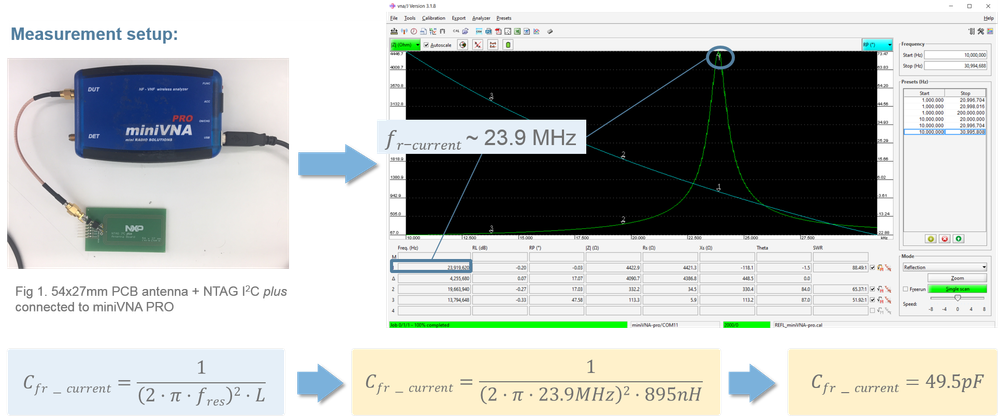

As described before, we need to start by characterizing our antenna coil. In this lab exercise, we have used a PCB antenna of 54 by 27 mm and, we have connected our miniVNA PRO to the antenna pads. The results that we have obtained from this measurement are that our PCB antenna has an inductance around 895 nH.
After characterizing the antenna coil:
  • We have soldered the NTAG I2C plus chip to this PCB antenna.
  • Right after, we connect again the miniVNA PRO to measure the actual resonant frequency.
In this case, it returns a resonant frequency near 24 MHz. Using the formula, we calculate that the tag capacitance at 24 MHz is almost 50 pF. Note that, the actual capacitance is basically the chip capacitance as the antenna and connection capacitance is usually not impacting significantly.
Obviously, a resonant frequency of 24MHz is way too high for a ISO14443 NFC tag like our NTAG I2C plus. Therefore, we need to add some capacitance to the system so that we can bring this resonant frequency down. As an example, for this lab exercise, we are adjusting the tag to around 13.6 MHz, intentionally a bit higher than the NFC operating frequency. With a target resonant frequency to 13.6MHz and an antenna inductance is around 895nH,  the result is that the tag needs a total capacitance of around 153 pF. This means that we need to solder an extra capacitance of 100pF to bring down the resonant frequency.  So we go to our component box, and select the closer commercial value (100pF).

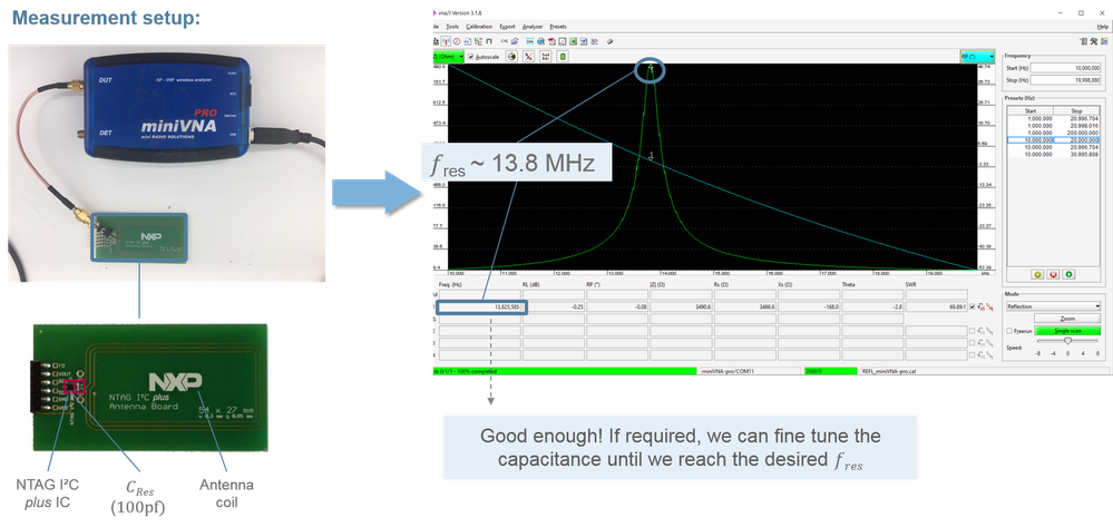

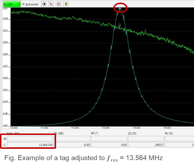

As a last step, it is worth to measure how well adjusted is our system after adding the 100pF. We connect the miniVNA to the system including the IC, the antenna and the 100pF. Now, the results obtained are that the resonant frequency is 13.8 MHz. In our case, we consider this as good enough. However, you are always free to repeat this process as many times as needed until you obtain the accuracy that you need.
