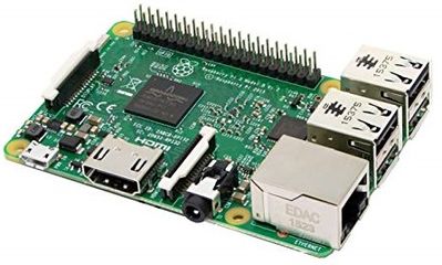

   - Raspberry Pi (any model) : https://www.raspberrypi.org/products/:

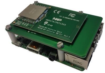

   - OM5578(PN7150 demokit) in RPi configuration (or OM5577(PN7120 demokit)
Then simply assemble boards together, stacking OM5578RPI (or OM5577RPI) to Raspberry Pi expansion connector:

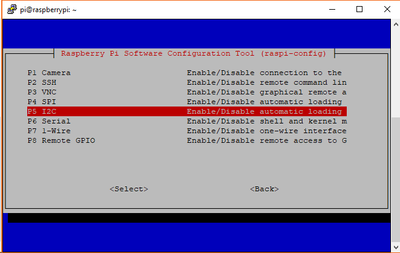

  • Enable i2c support:
       On Raspbian:
  1. Run "sudo raspi-config"
  2. Use the down arrow to select "5 Interfacing Options"
  3. Arrow down to "P5 I2C"
  4. Select "yes" when it asks you to enable I2C
  5. Also select "yes" if it asks about automatically loading the kernel module
  6. Use the right arrow to select the <Finish> button
  7. Select "yes" when it asks to reboot
      The system will reboot. when it comes back up, log in and enter the following command "ls /dev/*i2c*".
      The Pi should respond with "/dev/i2c-1" which represents the user-mode I2C interface.

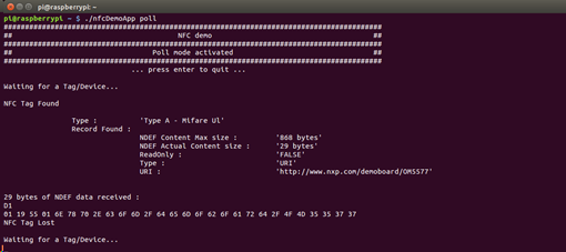

  • Run demo application (built and installed together with the library during previous step):
        To simply display all data collected from remote NFC device (Peer, reader/writer or card), run the demo application in poll mode executing the command:
   nfcDemoApp poll
        For more details about the demo application modes execute command:
   nfcDemoApp --help
