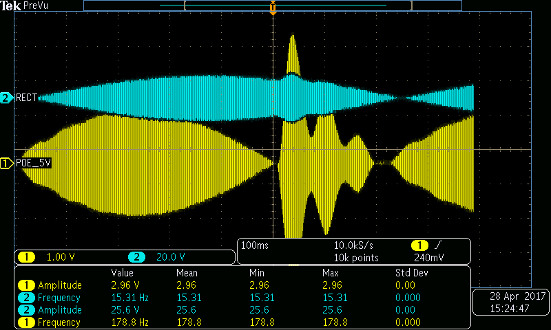

=> After switching to read mode am getting noise from the antenna and UNABLE TO RECEIVE RESPONSE FROM TAG.

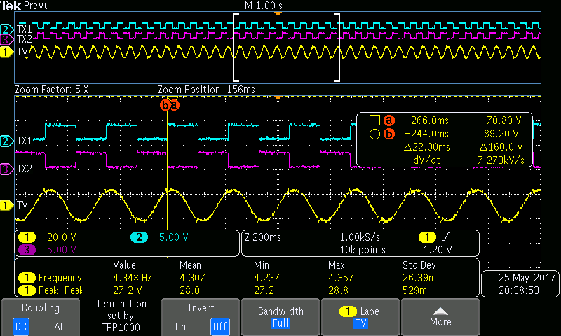

=> I checked the modulation on TX1 and TX 2 of HTRC110 and can see variation in it as shown in MOD_IMAGE below.
NOTE: Please ignore the labels.

2) Now we have the query related to pulse lengths for UID request to be sent to HiTagS:
      => We configured htrc110 in transparent mode
      => Pulse width of bit 0: 200 - 210us
      => Pulse width of bit 1: 240 - 260us
      Is this pulse width optimum? or withing range?
3) Also we are getting optimum amount of power on RF side. (Voltage of around 20V)
But still we are unable to receive response from HiTagS.
Please suggest some solution or workaround.
=> Also we observe UID request on analog side. We have set write pulse width to 8*T0 = 64us with 12MHz crystal. But when we changed the crystal to 16MHz we did not observe UID request on analog side. Do we need to change anything else other than FSEL value?
=> We are getting amplitude of 20V modulated waveform, is this voltage enough to power up HitagS?
