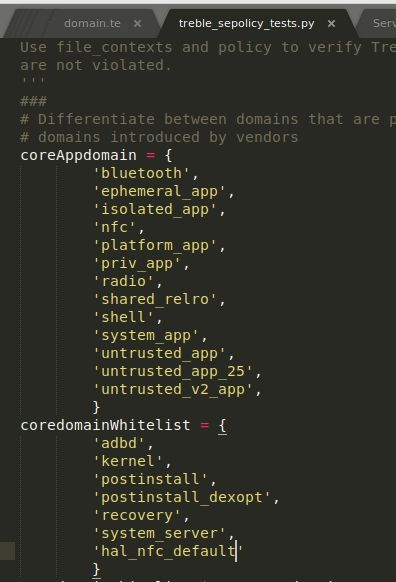

I'm trying porting PN7150 to rockchip 's rk3326 platform , which runs android oreo 8.1
I have followed steps of AN11690 , and merged rockchip's source with GitHub - NXPNFCLinux/nxpnfc_android_oreo: Android patches for support of PN7150 NCI based NXP NFC Co...
Then, I faced some issues which are not mentioned in AN11690 document.

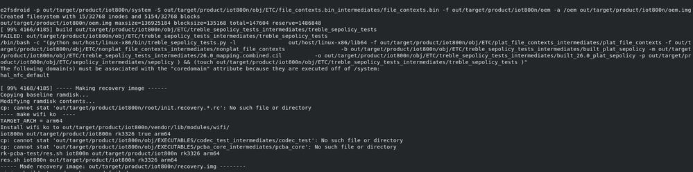

hal_nfc_default  sepolcy coredomain assiociated build error
later , i added hal_nfc_default in treble_sepolicy_tests.py's coredomainWhilelist  to solve this issue.
Then compiled and run the firmware into board.

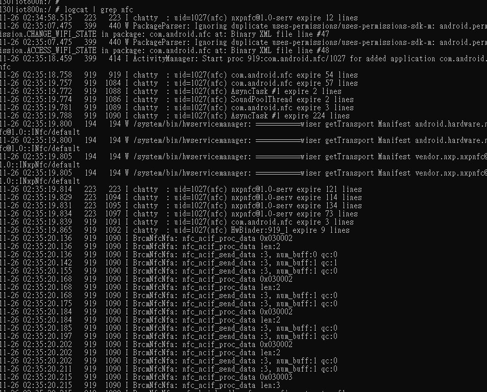

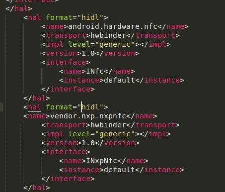

It has a runtime error of NFC hwbinder,  it can't find INfc/default interface of  manifest.xml
Afterward i add related INfc /default tag in the patch of manifest.xml to solve it
And AN11690 Step 3.1.5  doesn't mention the interface tag  should be added

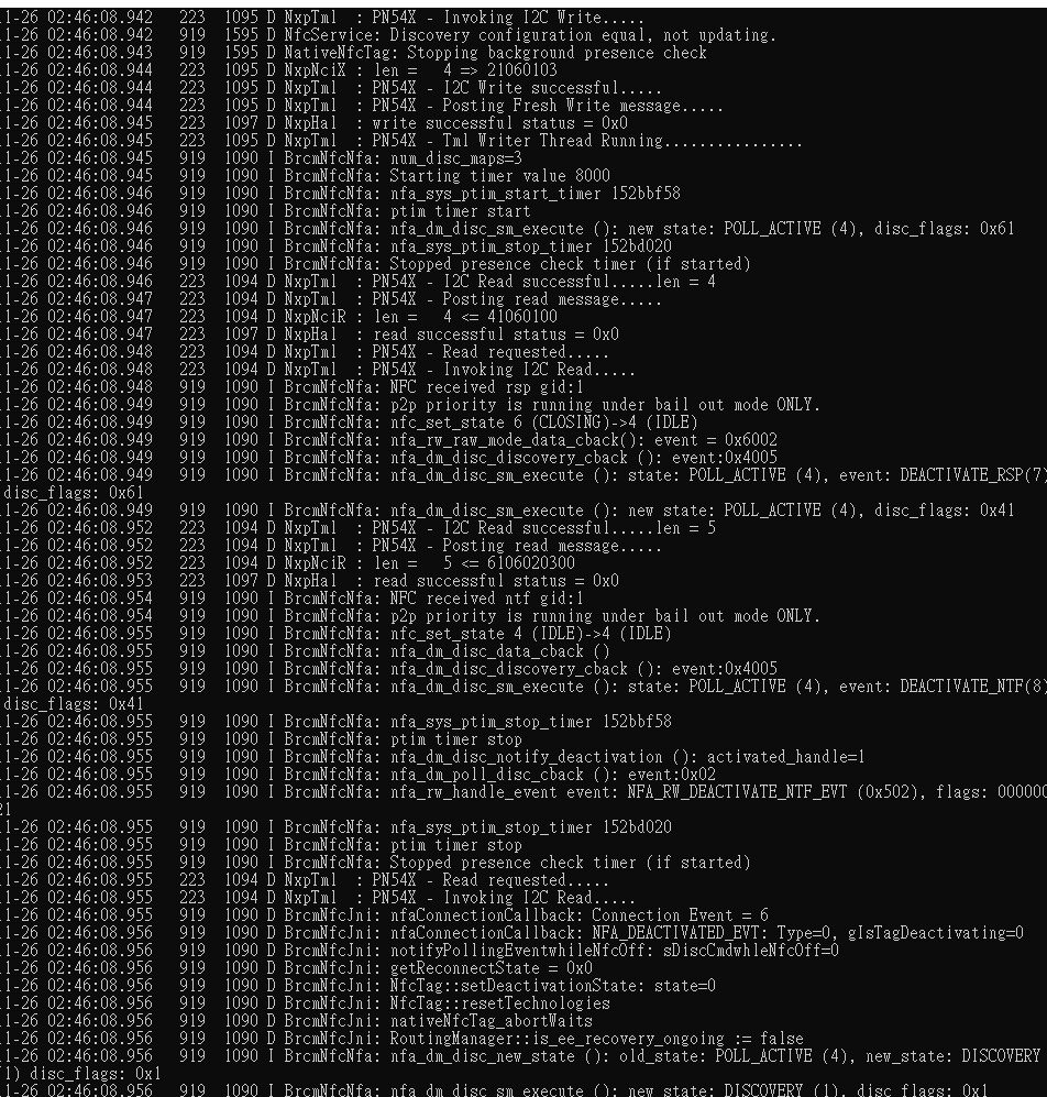

After this patch ,  Android's Setting have NFC option , but it is not worked still.

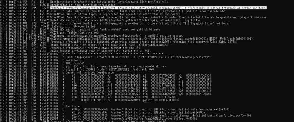

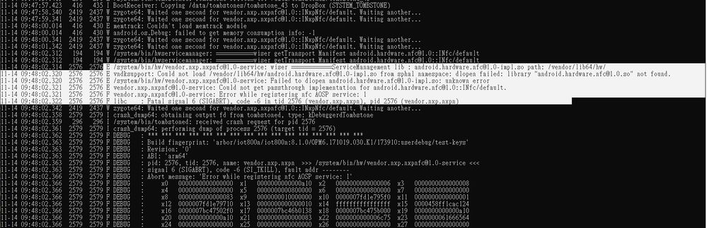

The newest issue  is about   vndk sphal  can't load   android.hardware.nfc@1.0-impl,so
but   android.hardware.nfc@1.0-impl,so  is actually located in /vendor/lib64/hw/

wiserkuo
Dear Nikolaos:
Thanks for your kindly help .
Although I have done all the changes you mentioned already ,  the final issue still continue  print as the error log as the last screenshot.
"Could not load....... from sphal namespace"
Then i tried to trace source , it is related to libhidl/transport/ServiceManagement.cpp  .
My android.hardware.nfc@1.0.so has always been load as sphal library.
,then i change "if (path != HAL_LIBRARY_PATH_SYSTEM) " to if(0) and let it always run "else" condition--> "dlopen(fullPath.c_str(), dlMode);"  .
After this modification , Nfc /pn54x  works .
