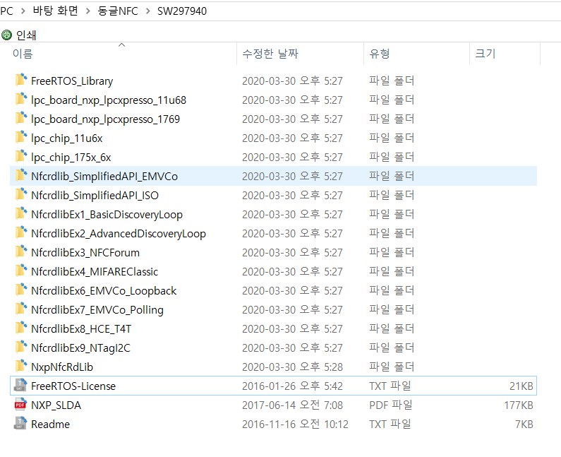

hi
i use pn512 chip.
I need to i2c source code about pn512.
I downloaded the example source code, but I don't know what to use
function is    pn512+ucom(nrf51822)  nfc leader.
NFC card is separately.
I want to i2c simple source code.
Which example should I use?

You may find it helpful to refer to the NFC reader library for PNEV512B and look for the initialization process for I²C. The examples are made for SPI communication mainly, but you may look for NXPBUILD__PHBAL_REG_LPCOPEN_I2C and adapt it to your specific implementation.
