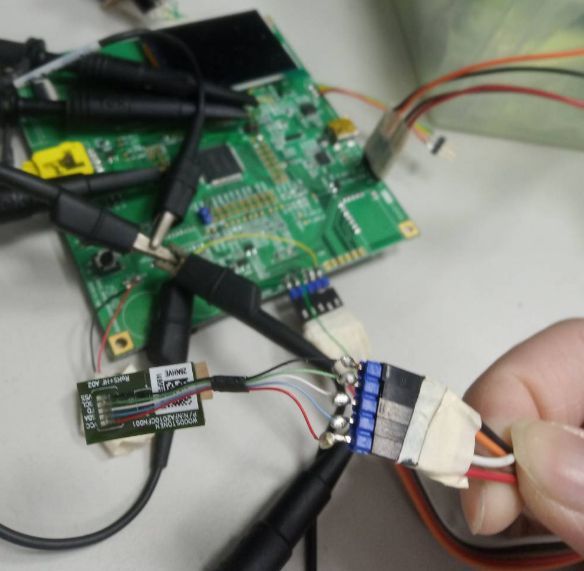

Hi, everbody, I'm York,engineer from Taiwan.
We'are designing a NFC module, choose MCU as Rensas RL78,
and connect to NT3H1101 supplied by Taiwan Woodstone Technologies Inc.
Now MCU is able to communicate with NT3H1101 either Read/Write by I2C.
And cell phone with NFC can read the value I write in from NT3H1101.
Then we want to use pass-through mode, and get problem.
We can adjust the NC_REG, FD_ON, FD_OFF, SRAM Read/Write,
but we don't know how to make a RF testing tool to test pass-through mode with MCU.
Agency in Taiwan said Android APP: NTAG I2C Demoboard has pass-through function for test.
but I can't figure out how this APP to use, then I google it,
and...there's a demoboard for APP to use?
Is APP: NTAG I2C Demoboard, can used for testing pass-through mode
to my MCU, without Demoboards for NFC connected tag chips by NXP? Including Transfer/Receiver.
And How do I control it?
If not, how do I make RF's transferring/receiving to test pass-through mode with MCU?
Many problem, look forward to your reply.

Maybe a bit late for your project right now, but for everyone else looking for the same answer:
To test Pass Through mode you need to read from NFC on the SRAM address, not the EEPROM NDEF area. Most Apps out there only read & write standard NDEF in the EEPROM area.
I use the Android APP "NFC Tools", go to tab "OTHER" and select "Advanced NFC commands".
Here you can specify the ISO standard and enter any NFC command + parameters in HEX. The app will calculate the CRC when sending. So to read the pass through area you simply use the READ command and specify the SRAM block address such as: 30h FCh to read the last 16 bytes in the SRAM (block FCh).

The demo board is the following: OM5569-NT322E | NTAG I2C plus Explorer Kit | NFC | NXP
There is also source code for the mcu implemented in this explorer kit which might help you to take it as a reference for your custom implementation. For this, please refer to the board's firmware source files available in the documents and software tab.
