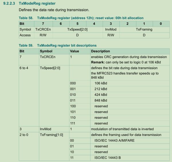

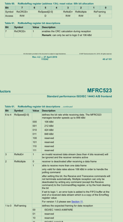

Hello, how to set the communication rate of mfrc523 to 424kbd or 848kbd? Is it only necessary to set TxModeReg register and RxModeReg register?Thanks!

Dear Binshen] LIN,
yes those are the two registers that need to be changed, it is important that the smart card or tag you are interacting with, supports this speeds. I want to mention that this device is not recommended for new designs please check our CLRC663. if you have more questions let me know.
Jonathan

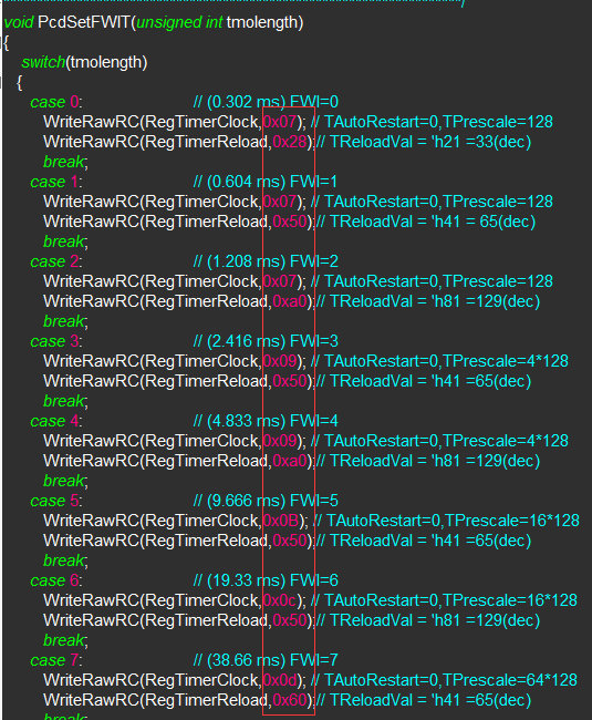

OK,thanks very much,Jonathan! I will use the clrc663 when I make another new product,and I have a know  for it. But now,I maintain the company's previous code of product that use mfrc632 .However ,I  confused about some code in setting FWT,could you make a explanation for me ? I will paste the a little code screenshot below. How the values in the red box are calculated using FWI.I'm sorry to disturb you again.

Dear Binshen LIN,
Hope you are doing great, for this information please look in the NxPNfcRdLib > comps > phpall14443p3b or phpall14443p4 or phpall14443p4a > src >  Sw> there ou can find a  .h file for example phpall14443p4_Sw_Int.h there are the definitions of the FWT please check this path.
Have a great day !
Jonathan
