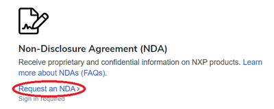

Hello @abderr
To use HITAG S in Authentication mode it is required to implement the encryption algorithm
used in HITAG S. This algorithm is not public available. To get access to this algorithm a software license agreement needs to be signed with NXP.
Signing such an agreement will require deeper discussions on the application and is subject to legal approval.
so please establish an NDA with NXP by going to  https://www.nxp.com/support/support:SUPPORTHOME and select "Request an NDA"
