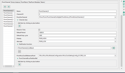

I am working on S32k3xx with MBDT.
Following is my model for PWM generation.
And following are my configuration on S32 CT
avinashstarkenn_1-1693111313295.pngavinashstarkenn_1-1693111313295.pngavinashstarkenn_2-1693111348898.pngavinashstarkenn_2-1693111348898.png
Still I am not getting pwm output on PTA1.

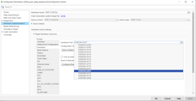

Hi, @avinashstarkenn ,
I see that you are using our default configuration for the S32K344-Q257 processor package that is set by default on a new model for S32K3. This selection is found inside the Hardware group and can be changed in accordance with your available hardware.
This configuration has been tested on the S32K3x4-Q257 evaluation board.
Could you tell us if you are using an evaluation board with the same processor version (S32K344) and package (257 pins)?

Hello @georgevictor ,
I have been using S32k344-Q172.

Hi, @avinashstarkenn,
I have download our s32k3xx_pwm_edge_aligned_s32ct example onto the S32K344-Q172 board and it works properly. Have you tried to check both pwm outputs, PTA0 and PTA1. Additionally, you can see if the RGBLED0_BLUE is turned on or off using a logic analyzer while the program is running.
Have you tried to run a debug session in S32 Design Studio using the .elf executable file generated with Simulink?
Do you have problems running other examples from our toolbox, such as the basic s32k3xx_dio_s32ct that toggles an LED?
