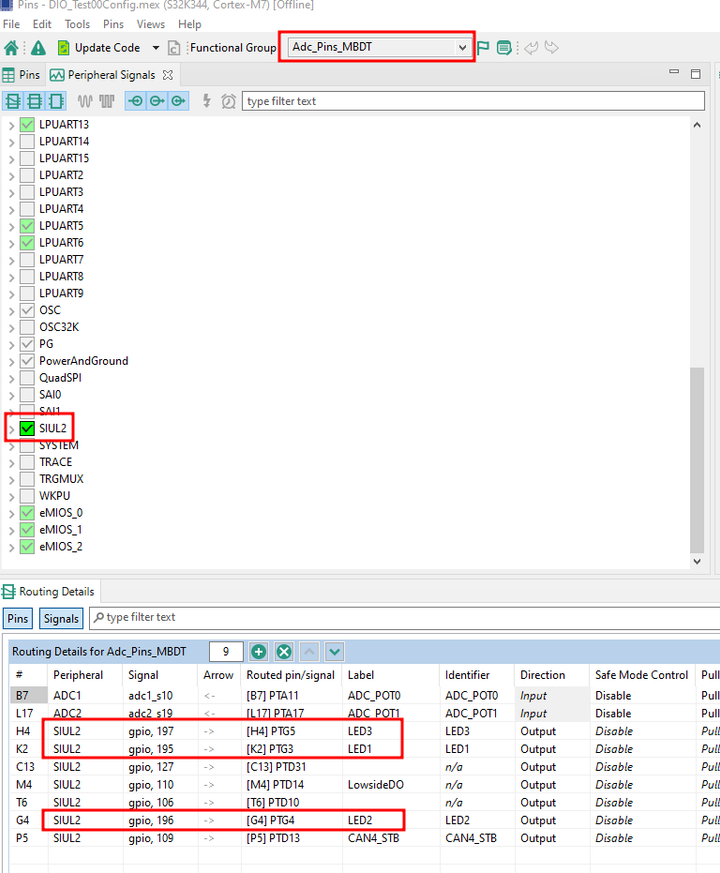

Referring to your configuration, I can see that the only change in the Port component is related to LED1 which has MSCR 29, which also corresponds to RGBLED0_RED.

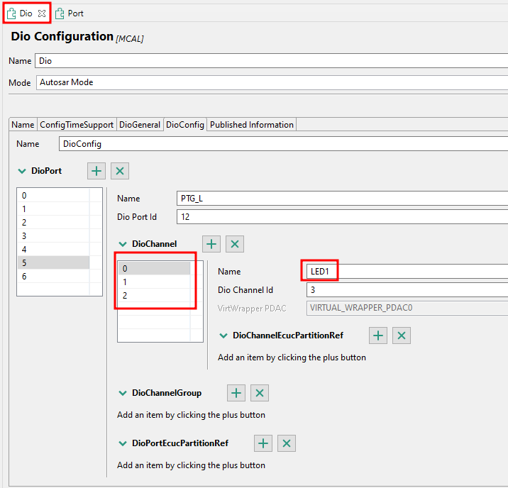

In the Dio section, I found LED1, LED2 and LED3 configured as PTG_L.
On the other hand, in the Pins section, I notice that the same pins are incorrectly configured, being assigned to the Adc_Pins_MBDT functional group. Instead, they should be set in the functional group corresponding to Dio, namely Dio_Pins_MBDT.
Moreover, MSCR registers must be synchronized between Port and Pins components, to ensure the connection between software and hardware configuration.

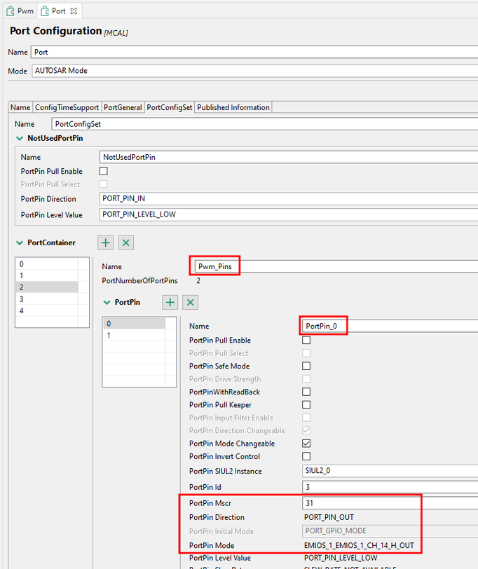

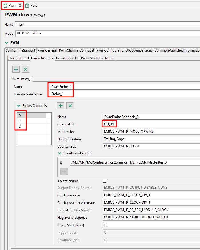

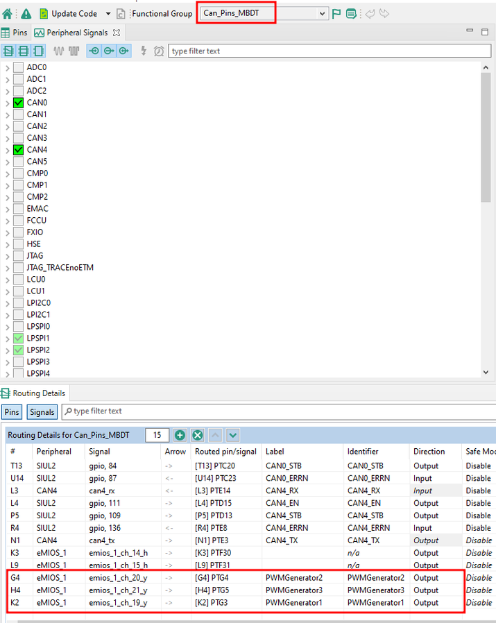

Now, on the other hand, related to the s32k344_pwm_led_s32ct model, I notice similarities in the configuration of the pins with the DIO_Test00 model. The PWM signals you want to configure use eMIOS instance 1 and channels 19, 20 and 21, but they are functionally assigned to the wrong group, they must be set in Pwm_Pins_MBDT.
In the Pwm component the PWM channels are correctly set, according to the eMIOS instances used.
But in the Port component, the pins you are trying to use are not configured correctly.

I have configured the DIO and PWM as you suggest and DIO working fine but I am facing issue with generating PMW output even I have configured as per you said. I have attached my PWM model here. Pls verify my configuration and need your suggestions.
