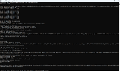

Hello nxp team,
We are facing this issue while deploying the code using simulink (mbdt)
P&E GDB Server for Arm(R) devices, Version 9.01.00.00
Copyright 2018, P&E Microcomputer Systems Inc, All rights reserved
Loading library C:\Users\Matlab(NTL)\AppData\Roaming\MathWorks\MATLAB Add-Ons\Toolboxes\NXP_MBDToolbox_S32K3xx\tools\eclipse\plugins\com.pemicro.debug.gdbjtag.pne.alpha_5.4.7.202301252033\win32\gdi\unit_ngs_arm_internal.dll ... Done.
Command line arguments: -device=NXP_S32K3xx_S32K344 -startserver -singlesession -serverport=7224 -gdbmiport=6224 -interface=USBMULTILINK -speed=5000 -port=USB1
Device selected is NXP_S32K3xx_S32K344
User Specified Hardware Selection : Interface=USBMULTILINK and Port=USB1
Connecting to target.
Unable to load libusb0.dll
PEmicro Interface detected - Flash Version 10.98
Starting reset script (C:\Users\Matlab(NTL)\AppData\Roaming\MathWorks\MATLAB Add-Ons\Toolboxes\NXP_MBDToolbox_S32K3xx\tools\eclipse\plugins\com.pemicro.debug.gdbjtag.pne.alpha_5.4.7.202301252033\win32\gdi\P&E\supportFiles_ARM\NXP\S32K3xx\S32K344.mac) ...o
REM Enable clocks for selected cores in MC_ME module (the sequence below enables all clocks).
REM Initialize RAM and DMA:
REM Initialize DMA TCD:
REM Copy valid executable code to RAM for each core to be used.
REM Enable required cores in MC_ME:
Delaying for 20mS ...
Done.
Reset script (C:\Users\Matlab(NTL)\AppData\Roaming\MathWorks\MATLAB Add-Ons\Toolboxes\NXP_MBDToolbox_S32K3xx\tools\eclipse\plugins\com.pemicro.debug.gdbjtag.pne.alpha_5.4.7.202301252033\win32\gdi\P&E\supportFiles_ARM\NXP\S32K3xx\S32K344.mac) completed.
Device is NXP_S32K3xx_S32K344.
Mode is In-Circuit Debug.
(C)opyright 2012, P&E Microcomputer Systems, Inc. (www.pemicro.com)
API version is 101
TARGET XML PATH is C:\Users\Matlab(NTL)\AppData\Roaming\MathWorks\MATLAB Add-Ons\Toolboxes\NXP_MBDToolbox_S32K3xx\tools\eclipse\plugins\com.pemicro.debug.gdbjtag.pne.alpha_5.4.7.202301252033\win32\gdi\P&E\supportFiles_ARM\target_v7m_vfp.xml
Server 1 running on 127.0.0.1:7224
Server 2 running on 127.0.0.1:7226
Server 3 running on 127.0.0.1:7228
Server 4 running on 127.0.0.1:7230
Server 5 running on 127.0.0.1:7232
Server 6 running on 127.0.0.1:7234
Server 7 running on 127.0.0.1:7236
Server 8 running on 127.0.0.1:7238
Server 9 running on 127.0.0.1:7240
Server 10 running on 127.0.0.1:7242
Server 11 running on 127.0.0.1:6224
All Servers Running
Connection from "127.0.0.1" via 127.0.0.1. Connection from port "62967" to 7224
Searching for Kernel Symbols...
rsp_qC - qSymbol: 5F74785F7468726561645F63757272656E745F707472
_tx_thread_current_ptr not found. ThreadX analysis not enabled.
rsp_qC - qSymbol: 707843757272656E74544342
pxCurrentTCB not found. FreeRTOS analysis not enabled.
Copyright 2023 P&E Microcomputer Systems,Inc.
Command Line :"C:\Users\Matlab(NTL)\AppData\Roaming\MathWorks\MATLAB Add-Ons\Toolboxes\NXP_MBDToolbox_S32K3xx\tools\eclipse\plugins\com.pemicro.debug.gdbjtag.pne.alpha_5.4.7.202301252033\win32\pegdbserver_console.exe" -device="NXP_S32K3xx_S32K344" -star?
CMD>RE
Initializing.
Target has been RESET and is active.
CMD>CM C:\Users\Matlab(NTL)\AppData\Roaming\MathWorks\MATLAB Add-Ons\Toolboxes\NXP_MBDToolbox_S32K3xx\tools\eclipse\plugins\com.pemicro.debug.gdbjtag.pne.alpha_5.4.7.202301252033\win32\gdi\P&E\supportFiles_ARM\NXP\S32K3xx\nxp_s32k344_1x32x1012k_hse_disab
.ARP file does not exist.
Error loading programming algorithm - load aborted.
Error occured during Flash programming.
Done.
PEmicro GDB Launch Failure : Error during flash programming. Terminating debug session.
Kindly help us to resolve this issue.

Hello @Vijay98
Could you please provide us more details on your setup so that we could furtherly investigate the issue you are encountering?
It would be of great help if you could share with us:
  • What hardware board are you using?
  • Are you using the on-board embedded debugger for downloading the code on the target, or an external probe? If the second option, please let us know what is the external probe you are using.
  • Is this behavior specific on a particular model or is it reproducible across multiple applications from the toolbox?
Thank you,
