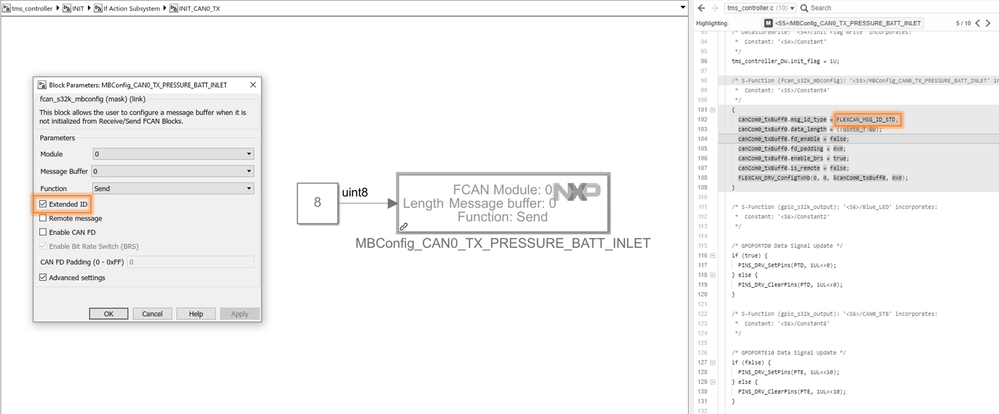

I am trying to send CAN messages with extended IDs, but they appear to be set to standard IDs even though I have enabled them as extended.

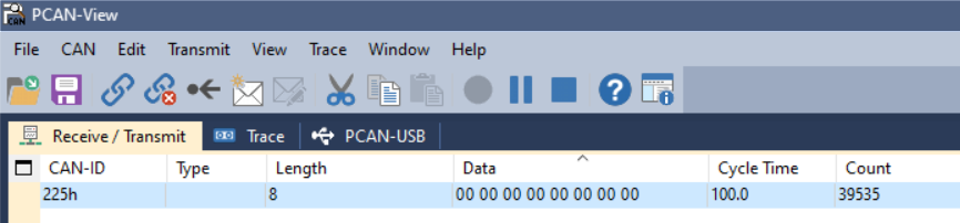

The CAN ID is 0x1CFF3225, but when receiving the message the ID is 0x255.
I have enabled extended ID in the mail box configuration block as shown below.  I noticed that in the generated code (on the right) shows that the msg_id_type is FLEXCAN_MSG_ID_STD (it should be FLEXCAN_MSG_ID_EXT)...

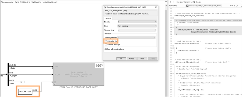

I also enabled extended ID in the send block as shown below...
I am using Model-Based Design Toolbox for S32K1xx Series Version 4.3.0
It seems that there is a bug and extended ID option is not being set in the generated code ?
How can I fix this ?

Hello @johngreenjets ,
Indeed. the Extended ID option from FCAN_MBConfig block doesn't function as expected, the msg_id_type is always set to standard ID.
To apply the attached cumulative patch NXP_MBDToolbox_S32K1xx_4.3.1_patch_20230830.zip follow these steps:
  1. Restart Matlab.
  2. Install the NXP Model-Based Design Toolbox for S32K version 4.3.0 toolbox if it is not already installed.
  3. Unzip the attached NXP_MBDToolbox_S32K1xx_4.3.1_patch_20230830.zip file.
  4. Run NXP_MBDToolbox_S32K1xx_patch.m file in Matlab
