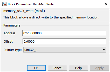

Hello Maciek‌,
The memory blocks DataMemRead and DataMemWrite, allows you on S32K access any memory memory address.
For example, the DataMemWrite Block allows you to write a Pointer Type value at the Address + Offset memory address.
This is the actual generated code
/* write to memory address */
<Pointer type> * address;
address = (<Pointer type> *) 0x%<Address + Offset>;
*(address) = <Input Value>;
However, I had a look on the S32SDK on the Flash Memory (Flash) Driver and I see that there is a driver that allows the user to write and read the memory as if dealing with an Eeprom using the flash_driver.c. If you have a short working example, I can add support to the functions you call directly from Simulink using custom code, the third method I've told you in the other thread. If not, just give me a few days to provide a working Simulink model.
