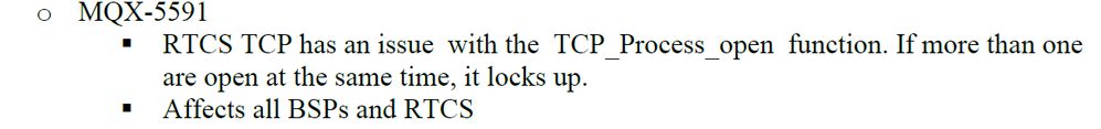

I made a daemon server to treat incoming TCP connections as suggested in many posts by NXP mods. I set a limit of connections to 5 using my own solution and that's working alright. The problem i have tho is that sometimes (it's not always and i have to make multiple tests to make it happen) all the child tasks that have a socket each gets stuck at send().

sometimes the child tasks will get stuck, after about 3min it gets unstuck and it returns the error 0x1635 which means TCP: Software caused connection abort.
Looking further in wireshark, when the stuck occurs it seems the device sends a TCP Zero Window, it seems the device does not have what it takes to send all the messages in a short time, but is there a way to circumvent this?

Hi Alvaro:
This issue is very similar to below issue
This issue is fixed in MQX 4.2.0.2.
I would suggest you update to MQX 4.2.0 and patched with mqx 4.2.0.2.   This version fixed some RTCS issues.
