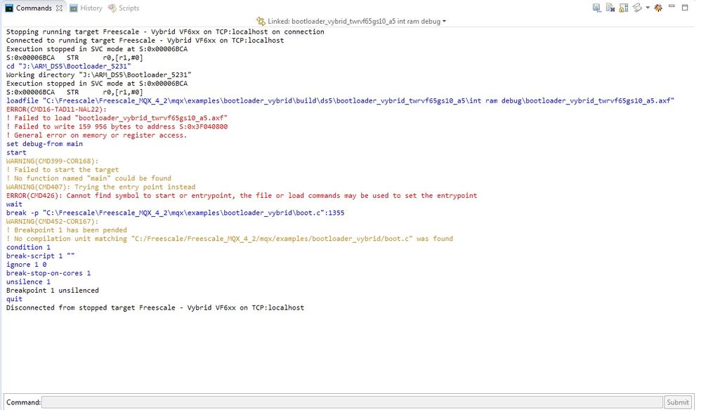

I am using win 7 64bit with MQX4.2 and DS-5 5.23.1(32bit). I am able to build project and it is working when I upload *.bin files to SD card (MQX on A5 and Baremetal project on M4). But I am unable to debug bootloader from your examples (bootloader_vybrid) on A5 there is always error (picture attached). I can debug both applications for A5 and M4 core but not bootloader.
I have tried same bootloader example under Linux (Ubuntu 14.04 LTS 32bit, MQX RTOS 4.2.0 and linux version of DS-5 5.23.1). On Linux version of DS5 is no problem to debug bootloader and it is fully functional. Do you have any idea why is it not working on windows?DS5.jpg

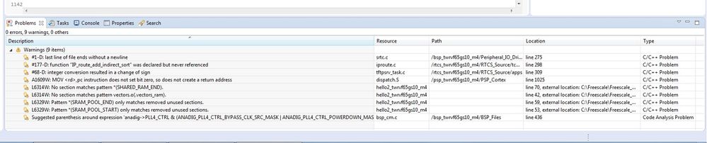

I am attaching warnings and errors from different example project with MQX4.2, DS-5 v5.23.1 win7:

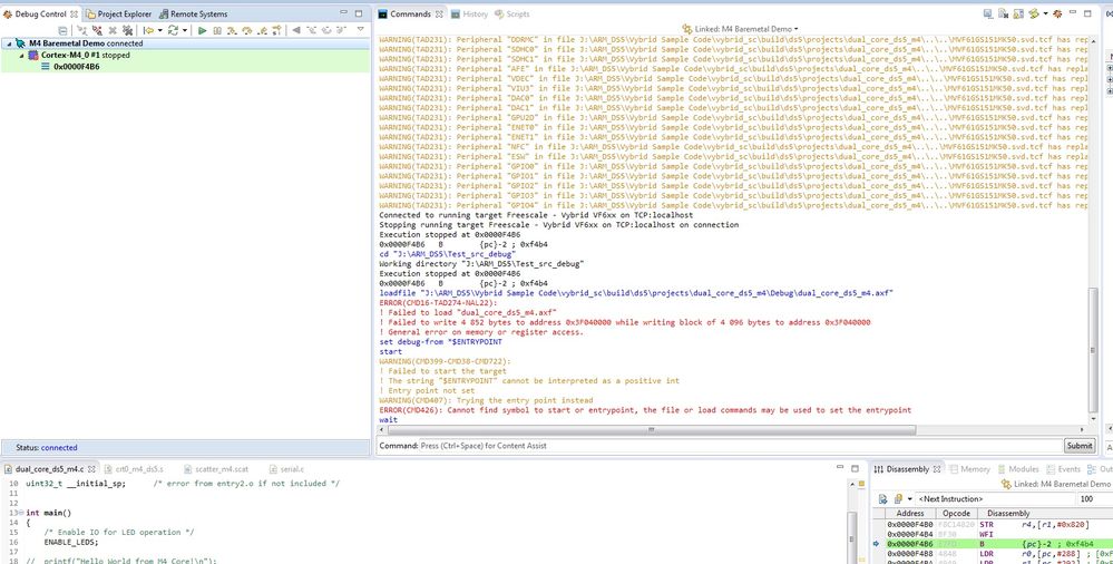

I have tried one more thing. I have ran new project with dual_core_ds5_m4 example. This project occasionally run in debuger correctly. I have tried various combinations of HW interconnection (different USB port, shorter cabel, unplug USB before every run,...). I still don't have clue what could go wrong. Below is attached output for both cases:
