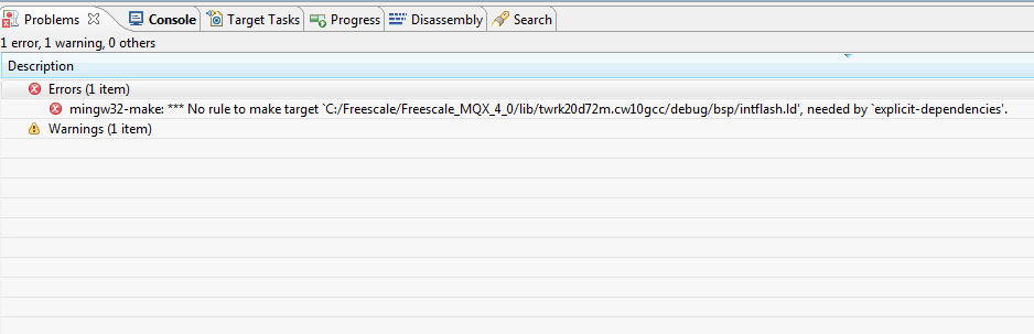

I am using TWR-K20D72M   and I opened a Sample program (Freescale\Freescale_MQX_4_0\mqx\examples\hello ) which is given in the MQX 4.0.1 Demo examples. When I choose Build tool option as  Freescale
the program compiles OK but When I choose Build tool option as GCC It gives me error.The Error is below
error
DescriptionResourcePathLocationType
mingw32-make: *** No rule to make target `C:/Freescale/Freescale_MQX_4_0/lib/twrk20d72m.cw10gcc/debug/bsp/intflash.ld', needed by `explicit-dependencies'.MQX_MODBUS_TEST1C/C++ Problem
I read somewhere  that The GCC can only work with MQX 4.0.1 and above so I am using MQX 4.0.1 .
Can some suggest me the reason for this error.How I can I remove this error.......

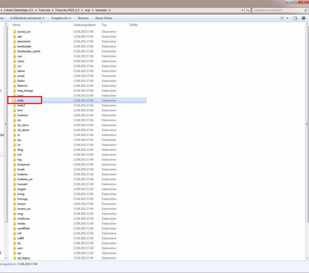

yogesh8418
Hi martin
I am just executing the hello world example in the mqx example folder as shown in the picture below.
and the error is shown below in the picture.

Martin_
You have to build MQX libraries for GCC compiler first, before an application. Drag and drop
c:\Freescale\Freescale_MQX_4_0\config\twrk20d72m\cw10gcc\twrk20d72m.wsd
into your Project window in CW 10.4 IDE and build the MQX libraries. At post built step, the linker command file will be copied from the bsp folder to the lib folder. Then build the example application.
