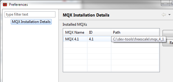

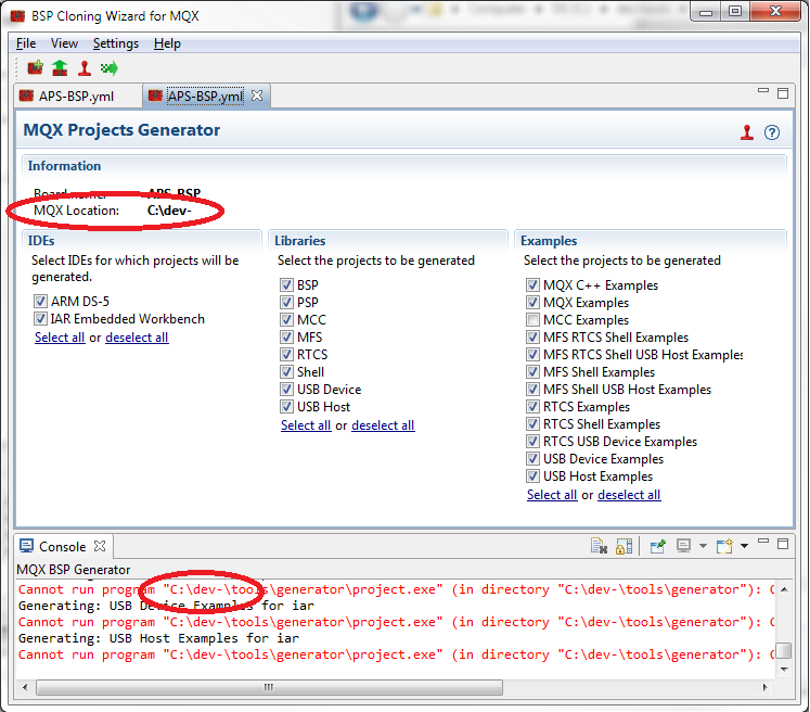

There is a problem with the BSP Cloning Wizard when the MQX install path contains a "-" (dash) character.
In the image below the actual installation path of MQX is "c:\dev-tools\freescale\mqx_4_1", however the Cloning Wizard incorrectly parses the path to "C:\dev-".  I copied MQX to a different folder name and the Cloning Wizard operates normally.

Note: In fact problem wasn't with dash character in MQX installation path, but with word "tools" (BSP Cloning Wizard is located in "../MQX_4_x/tools/" directory) and this caused problem in wrong parsing of the MQX location. It was fixed (change will be applied from MQX 4.1.2).
I hope it helps you.

I know from bitter experience that there is also a problem if the chosen "custom board name" contains a dash. This is because that name is used in many places, including in generated code, and dash is not valid in a C identifier. The cloning wizard doesn't warn about this and generates code that won't compile.

Note: Thank you for notification. It was fixed – it will not possible create board name with dash character (change will be applied from MQX 4.1.2).
