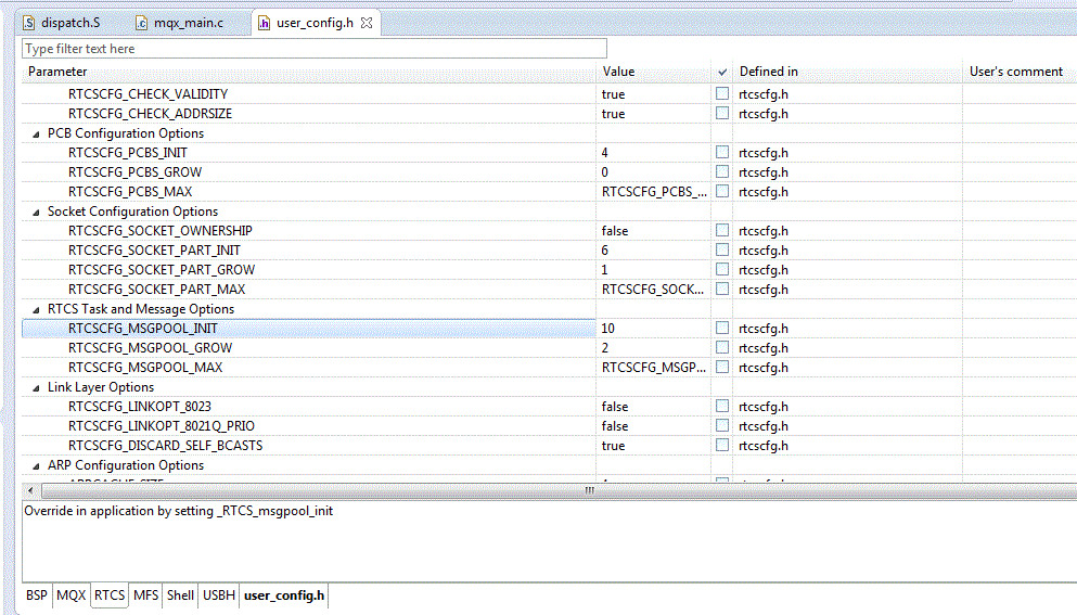

“_init” is pre-allocated count, allocation happens when RTCS starts. During runtime, when RTCS needs more of these resources, it allocates more by "_grow" chunks until the "_max" is consumed, which is the effective limit for RTCS resources. These parameters must be called before _RTCS_start
By default these parameters are defined as RTCSCFG_PCBS_INIT, RTCSCFG_PCBS_GROW, RTCS_PCBS_MAX, RTCSCFG_MSGPOOL_INIT, RTCSCFG_MSGPOOL_GROW, RTCSCFG_PCBS_MAX, RTCSCFG_SOCKET_PART_INIT, RTCSCFG_SOCKET_PART_GROW,  RTCSCFG_SOCKET_PART_MAX. In application we can override these defaults by _init, _grow, _max. We also can override these in user_config.h.
How to configure these parameters?   We don’t have a formal method how to configure these for a specific application. We can start with the defaults and then spent some time increasing these parameters, then we can use RTCS TAD window to see, what RTCS resources are out. Then increase the one a bit.
