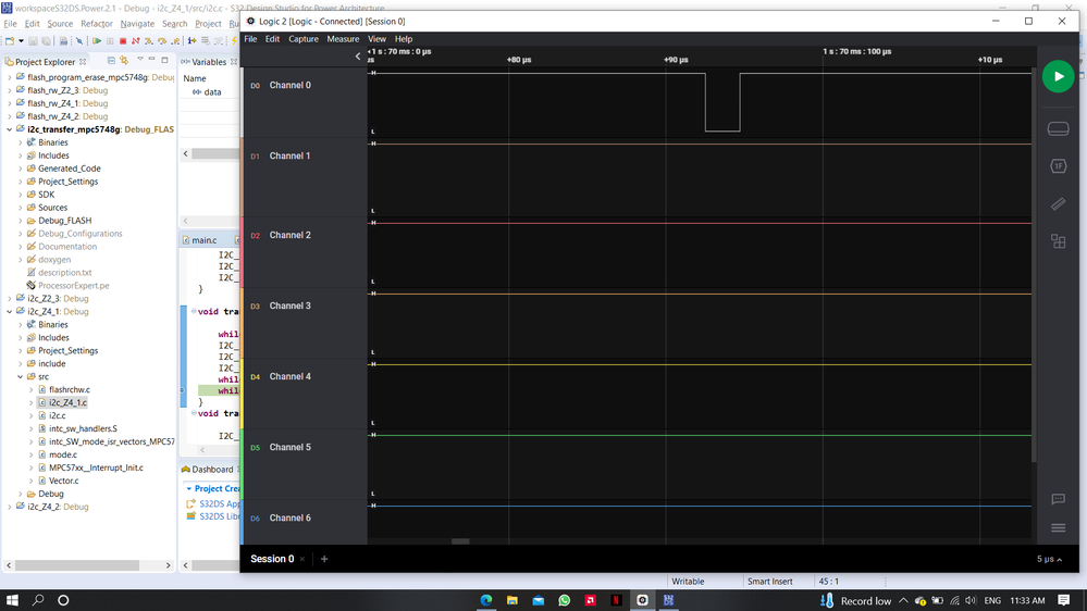

hi i wrote the following code from the given example code which sends a message using i2c.
i got the massage using logic analyzer.
i want to send an array rather than 1 message, the code is :

logic analyzer:

PetrS
if you want to write own code or modify this demo example you can follow section 44.7 Initialization/application information of the RM.
Also you can refer to simple i2c driver at https://community.nxp.com/t5/MPC5xxx-Knowledge-Base/MPC5xxx-I2C-communication-driver/ta-p/1121925.
BR, Petr
