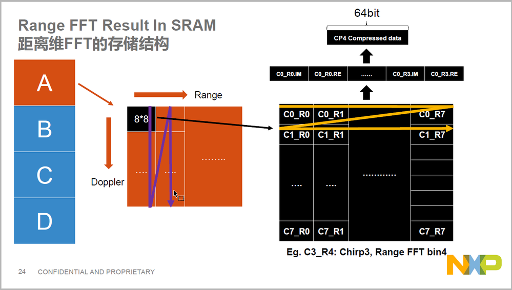

How to understand this picture?
What is the result of RFFT being stored in ORAM?

    SPT memory is accessed by 8*8slice at once(increase column address),SARM memory is accessed by 64bit at once(increase row address).The direction of the arrow above is my addressing direction。
