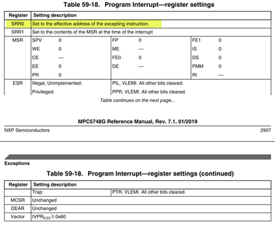

first, I would try to find out what caused the exception exactly. For example, if you got Program Interrupt (IVOR 6) then you can get following details from core registers:
SRR0 is the most interesting - it points to instruction which caused the error, so it may provide more hints about the root cause. The same table you can find for other exceptions in the reference manual.

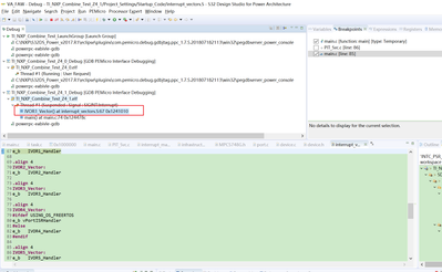

Here is the debug result:
Core0:
The STM interrupt(which is necessary for saferots) is enabled, and safertos system is running well.
Core1:
a IVOR1 error is triggered
