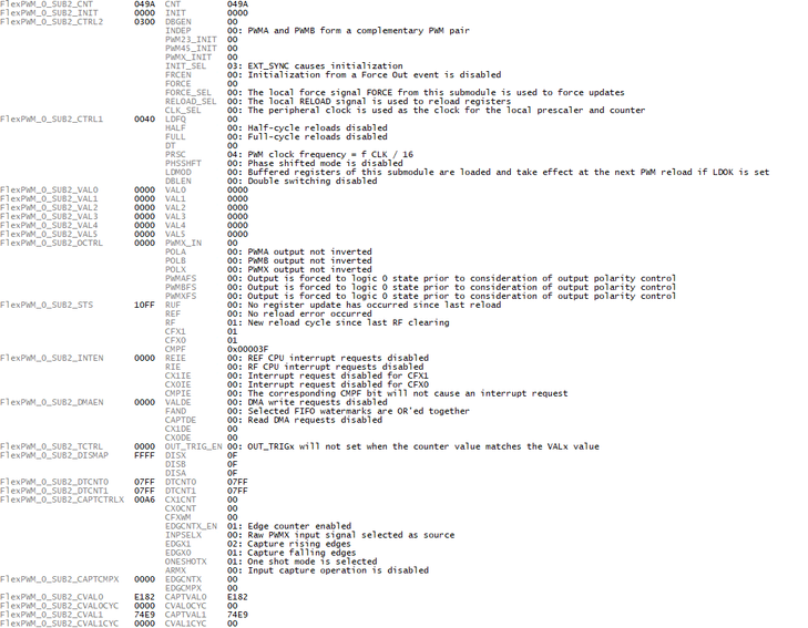

Meanwhile, the same device connected to the input #2 (FLEXPWM0_X2) has this register snapshot. Notice that the CNT register is well beyond 0x1000. And capture difference yields 37000.

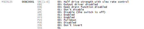

Regarding the FLEXPWM1_X3 pin, MSCR125.SSS = 1:
IMCR74 is configured in another code part (for another pin), but I understand it has no relevance here.

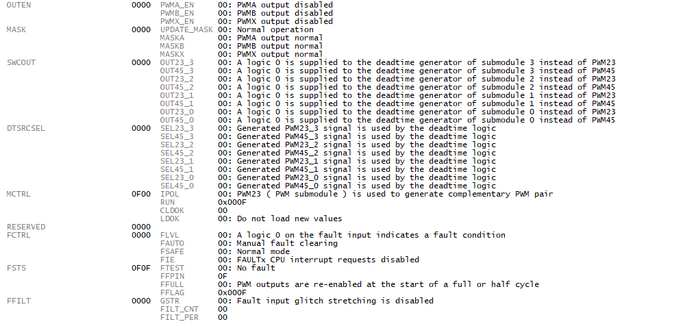

FlexPWM1 configuration
And FlexPWM0 to compare
I am completely lost on this one. I don't understand how under the same configuration,  FLEXPWM0 {1, 2, 3} are able to count 0000...FFFF, but on the other hand, FLEXPWM1 {3} is not able to count beyond 0x1000 (I didn't test the actual maximum value it overflows, but checking it real time with TRACE32, I can guarantee that at least).
