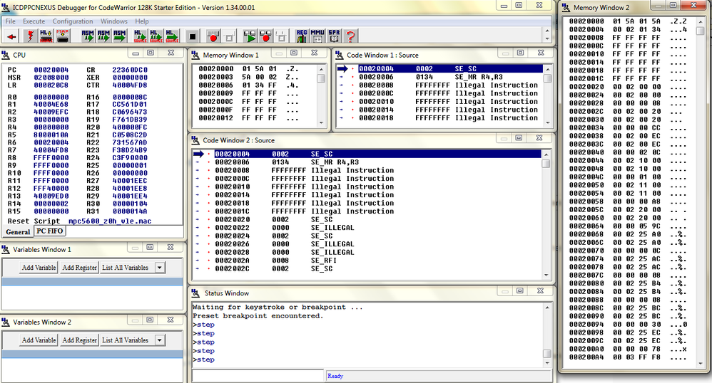

bjrajendra
Senior Contributor I
Hi Peter,
Thanks for your swift response. I developed Flash bootloader in sector B0F0 and user application in B0F5. Now as per the thread we need to jump to 0x00020004 address to start the user application. But if I do that IVOR trap is happening. Now I need to know to which address location I need to jump to execute the exact user application.
Thanks in advance,
BJ Rajendranath
3,464 Views
petervlna
Most probably you are getting illegal instruction IVOR. I expect you executing jump to location where you have no code loaded. Please check it.
Share debugger memory screen of address 0x20004 first.
Peter
3,464 Views
bjrajendra
Hi peter,
Now I got something. Once it jumps to user application, in the assembler section it can be seen the execution of system call instruction (se_sc instruction) which actually creating IVOR8 interrupt. One can see the below screen shot which is executing se_sc instruction and therefor the IVOR8 interrupt occurs. Now I need to know the things to be performed in my bootloader application so that the execution of se_sc instruction wont lead to IVOR8 trap. Some thing I need to do with vector address shifting.
Hope you understand my problem and comeback with solution,
