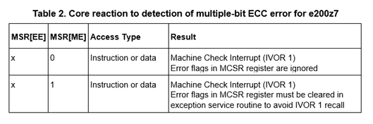

I have worked for ERM.I  over-programming Flash  to generate a non-correctable. I used sample programme on Forum. I wonder that what is purpose of SetMSR_ME func on this example? When I try to debug my source during overprogramming, controller doens't enter ISR function called ERM_IRQHandler.  I initiliaze ERM for controller. * ERM_init();
I enable interrupts by using this function *INT_SYS_EnableIRQ(ERM_IRQn);

No, it will go to IVOR1 in both cases. The only way how CPU can process fault read is bus error.
The only exception is data flash where flash controller can return ECC-clean illegal opcode value 0x1555_1555 (according PFCR3[DERR_SUP] setting).

MSR_ME has only little impact, core goes to IVOR1 exception in any attempt to read/execute ECC affected data.

If you mean following example
https://community.nxp.com/t5/MPC5xxx-Knowledge-Base/Example-MPC5777C-1b-2b-FLASH-ECC-error-injection...
if goes to IVOR1 exception which is calling ERM handler.
But ECC error may be also detected by different master than core (eDMA for instance), it this case ERM interrupt should be invoked.
