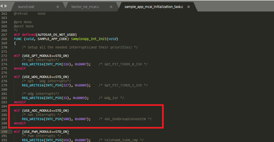

Hello
Dears
I have problems compiling this sample from NXP. According to the release note the project is configured and test for MPC5744P-144DC Adapter Board Rev C1 and etc... . I am going to run this sample on DEVKIT-MPC5744P from NXP(same chip and derivative). So I changed some configurations in EB Tresos on PORT, DIO, ADC, and PWM modules and changed the corresponding parameters according to this evaluation board. EB generation was ok but when I compiled the project using launch.bat, there were some errors in the generation. I attached the project files and some images from the configuration. thanks in advance for your help...

Hello @Ehsaaan ,
The vle file is correct, but please also update the file sample_app_mcal_initialization_task.c. We should enable the interrupt number 500 but not 496(because currently we use ADC1 but not ADC0).

Hello @Ehsaaan ,
As I can see, you are using  ADC1 instead ADC0, that why the Adc_Adcdig_EndGroupConvUnit0 will not be defined and it should be removed in the Vector_vle_mcal.s file
The same problem with the FLEXPWM_0_SUBMOD_0_CMP_ISR. The FLEXPWM_0_SUBMOD_0_CMP_ISR is not defined in the Pwm_Cfg.h, because the PWM notification has been disabled in the GUI configuration. Then it should be removed in the Vector_vle_mcal.s file

Ehsaaan
@hungnguyenphi, OK I cleared those expressions in vector_vle_mcal.s file, there wasn't any error in compile process, but the code didn't work correctly in debugging (trace32). Isn't it necessary to add or replace Adc_Adcdig_EndGroupConvUnit0  with Adc_Adcdig_EndGroupConvUnit1 for the proper performance of code? in debugging in the ADC task .c file it went on pending state and got stuck in timeout and breakout the code after.
I attached my startup file, kindly please find the attachment and take a look at it. thanks in advance...

Hello @Ehsaaan ,
