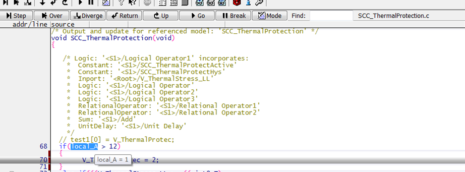

The code is shown below:

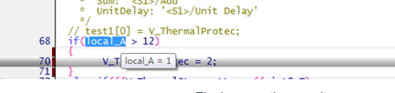

                                                                Fig.1   operating result
In the code, variable named "local_A" is always equal to 1, the PC pointer can't jump into the branch.
But actually the judgement  condition is false, the PC pointer is still jump into the branch.  you can see the result in Fig.1.

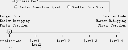

at last, we found there is a parameter can lead to this problem. The parameter is "Global Optimization Settings".
                     Fig.2  Faster build option
If this Global Optimization Settings is set as Fig.2 or optimization level is less than 4, the problem will reappear.

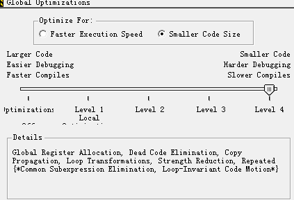

                          Fig.3  smaller code size build option
Only this Global Optimization Settings is set as Fig.3. The problem  will never happen.

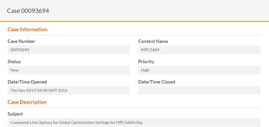

I create a new case. shown below:
Thanks for your help.
