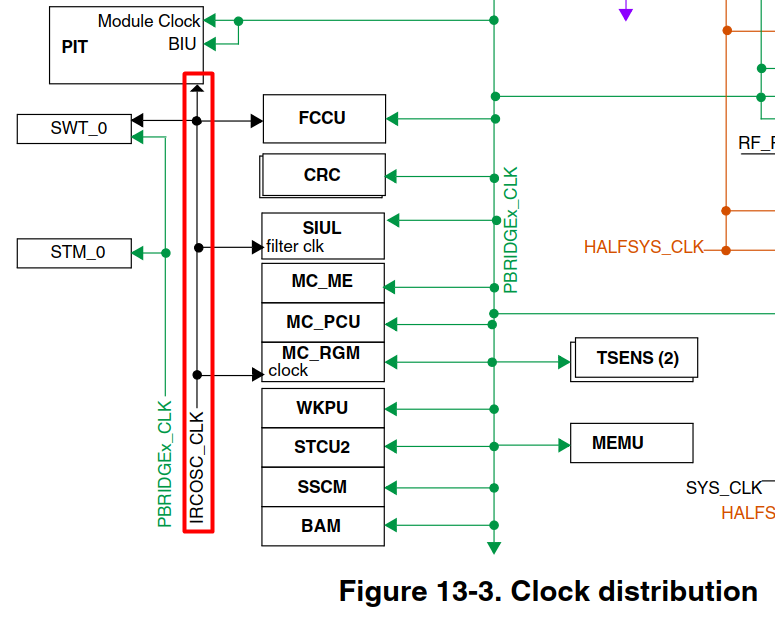

I have a problem to speed up the calculation of the MPC5744P by changing the system clock frequency.
First of all, 16 MHz IRCOSC was used as the system clock ( MC_ME.RUN0_MC.B.SYSCLK = 0;)and I tested  the time for MPC5744P to process a formula, it takes around 100us (Testing by PIT) .Then I used the primary PLL (PHI) as the source of system clock ( MC_ME.RUN0_MC.B.SYSCLK = 2), so the system clock frequency is supposed to be 160MHZ. But the processing time stayed unchanged .
Could you give me some advice on why I cannot speed up processing speed by changing  system clock frequency ?
Bruce
2,362 Views
davidtosenovjan

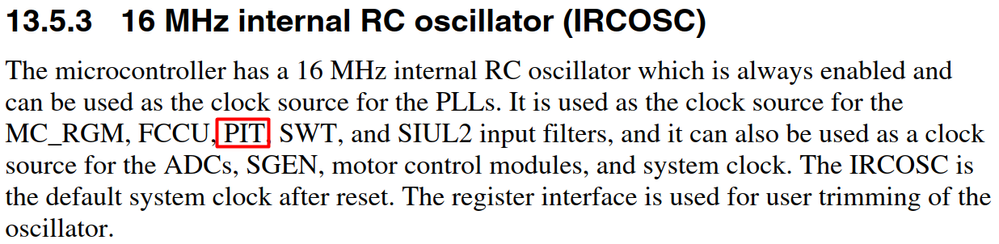

Hi, it is not supposed to be changed. PIT uses IRC as clock source:

davidtosenovjan
I see.
Please pay attention to following example code, functions SysClk_Init and PeriClkGen_init:
Example MPC5744P PinToggleStationery S32DS
Hope it helps.
