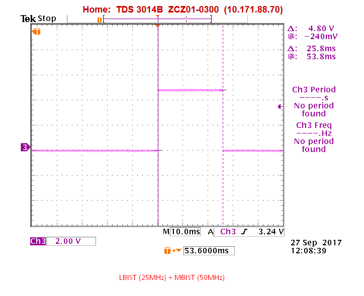

STCU2 On-line BIST (MBIST+ LBIST) execution time on NXP Evaluation board ( X-MPC5777C-561DS) is 25.8ms.
This measured time is valid for:
System clock PLL = 200MHz
STCU module clock = System clock / 4
MBIST = 50MHz
LBIST = 25MHz

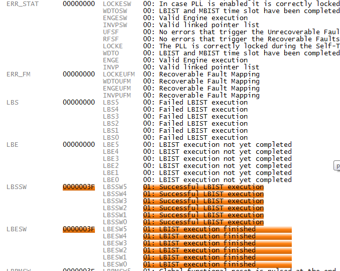

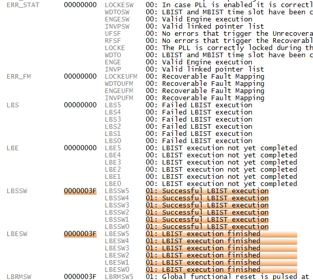

Result after testing MBIST+LBIST = 0 faults latched in ERR_STAT register and all LBISTs was successfully executed.

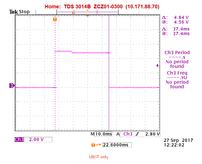

STCU2 On-line LBIST only execution time on NXP Evaluation board ( X-MPC5777C-561DS) is 37.4ms.
LBIST = 25MHz

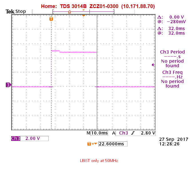

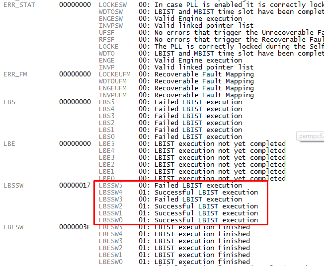

LBIST on 50MHz
I do not recommend to run LBIST at 50MHz as it was failing in my setup.
