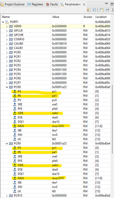

I can view the peripheral register at runtime and see that both pins are configured as expected:
However, the pin outputs remain low. (I am measuring the voltage levels on the Arduino Header J2-20 and J2-18 on the demo board).

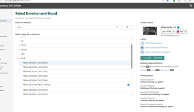

Harry_Zhang
Hi @aberger
You can download the MCXA153 SDK from the NXP official website.
Select Board | MCUXpresso SDK Builder (nxp.com)
In SDK_2_16_000_FRDM-MCXA153\boards\frdmmcxa153\driver_examples\i3c,
there are i3c examples.
there are pin config in the example, you can refer to it.
Hope this will help you.

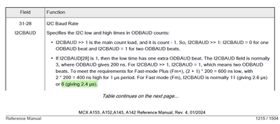

I noticed that the i3c_master_enable_t included in fsl_i3c.h does not include an enumeration for I2C Controller mode (MSTENA = 0b11). Is this a problem?
Lastly, the description of I2CBAUD in the Reference Manual with regards to how the I2C baudrate is calculated is quite unclear. From the manual:
I2C Baud Rate
Specifies the I2C low and high times in ODBAUD counts:
  • I2CBAUD >> 1 is the main count load, and it is count - 1. So, I2CBAUD >> 1: I2CBAUD = 0 for one ODBAUD beat and I2CBAUD = 1 for two ODBAUD beats.
  • If I2CBAUD[28] is 1, then the low time has one extra ODBAUD beat. The I2CBAUD field is normally 3, where ODBAUD gives 200 ns. For I2CBAUD >> 1, I2CBAUD = 1, which means two ODBAUD beats. To meet the requirements for Fast-mode Plus (Fm+), (2 + 1) * 200 = 600 ns low, with 2 * 200 = 400 ns high for 1 μs period. For Fast mode (Fm), I2CBAUD is normally 11 (giving 2.6 μs) or 6 (giving 2.4 μs).
Should I understand this to mean the following:
T_low_I2C = ((I2CBAUD >> 1) + 1 + (I2CBAUD & 0x1)) * T_ODBAUD
T_high_I2C = ((I2CBAUD >> 1) + 1) * T_ODBAUD
which implies:
T_I2C = (2 + 2*(I2CBAUD >> 1) + (I2CBAUD & 0x1)) * T_ODBAUD
This works for the example of I2CBAUD = 11, but not for I2CBAUD = 6. However, in the attached project I have configured the following:
  • FCLK = 24 MHz (I3CFCLKDIV = 4)
  • Push-Pull baudrate = 2 MHz
  • Open-Drain baudrate = 500 kHz
  • I2C baudrate = 100 kHz
I can see from the Peripherals that
  • PPBAUD = 5
  • ODBAUD = 3
  • I2CBAUD = 8
Since the I2C baudrate is 5x slower than the OD baudrate, this suggests that
T_I2C = ((I2CBAUD >> 1) + 1) * T_ODBAUD
But this calculation doesn't agree with any of the examples in the Reference Manual.
Can you help me understand where my calculation is wrong so that I may figure out the I2CBAUD settings (and related clock frequencies and divisors) necessary for my application (which requires an I2C baudrate of 100 kHz)?

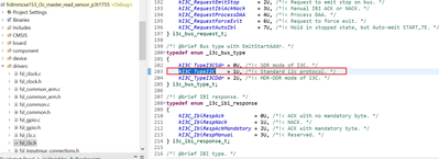

1. You can try measuring this pin through an oscilloscope when sending commands or data.
2.  When you use the I2C, you can use kI3C_TypeI2C,

• FCLK = 24 MHz, I3CFCLKDIV = 4
• Push-Pull baudrate = 2 MHz (PPBAUD = 5)
• Open-Drain baudrate = 500 kHz (ODBAUD = 3)
• I2CBAUD = 8
ODBAUD calculation:
TODBAUD = 1/500kHz = 2us.
Tlow_I2c = (8/2 + 1 +0) *2 us = 10 us
Thigh_i2c = (8/2 + 1)*2 = 10us,
Ti2c = 10 +10 = 20 us
So the Fi2c = 50kHz.
This means that with I2CBAUD = 8, your I2C clock frequency would be 50 kHz, which is different from the expected 100 kHz. To achieve a 100 kHz I2C clock, you would need to adjust the I2CBAUD value accordingly.

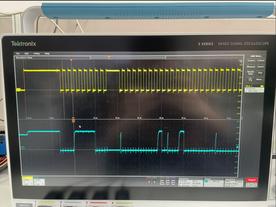

aberger
Senior Contributor I
Hi @Harry_Zhang ,
1. This is precisely what I am doing: measuring the I3C pins (P1_8 and P1_9) with an oscilloscope when sending commands or data. See the previously attached project. Upon execution of BOARD_InitBootPins(), the pins remain held low (unexpected behavior). Upon execution of I3cSendCommand() (which is configured to send with a busType of kI3C_TypeI2C),  I3C_MasterTransferBlocking() returns early with a kStatus_I3C_Busy because the masterState was detected as kI3C_MasterStateSlvReq ("slave holding SDA low"). So the pins are never released to an open drain and pulled high.
2. I am using kI3C_TypeI2C. See the definitions of I3cSendCommand() and I3cRecieve().

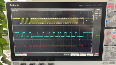

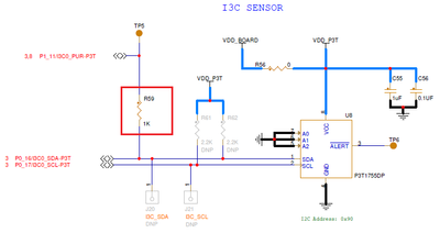

Harry_Zhang
Hi @aberger

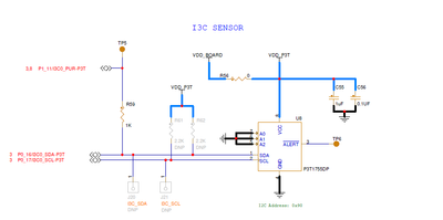

I tested the P0_16 and P0_17 in i3c_polling_b2b_transfer through oscilloscope. when transfer the command and data. The SDA is high.
I have attached an oscilloscope image.
It can work.
And i tested the P1_8 and P1_9, it can not work.
You can check the schematic,
P0_16 has connected a pull-up resistor, and P1_8 has not connected a pull-up resistor.
So if you want to use the P1_8 as the SDA function,
you need to connect a pull-up resistor.
Hang

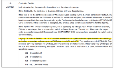

I'll also add that the operation shown here (https://community.nxp.com/t5/MCX-Microcontrollers/I3C-SDA-and-SCL-pin-configured-for-Pullup-Enabled-...) only demonstrates that SDA is open-drain and using the pull-up resistor. I need the SCL to be open-drain as well to permit clock-stretching by the target device. In your oscilloscope capture, the SCL is clearly push-pull. However, the Reference manual clearly states that clock-stretching is supported by the I3C peripheral.
However, perhaps the highlighted sentence means that the internal pull-ups are not sufficient when operating in MSTENA = 11b (I2C Controller mode)?
Furthermore, your solution only demonstrates that SDA is open-drain and using the pull-up resistor. I need the SCL to be open-drain as well to permit clock-stretching by the target device. In your oscilloscope capture, the SCL is clearly push-pull. The Reference manual clearly states that this is supported.
However, perhaps the highlighted sentence means that the internal pull-ups are not sufficient when operating in MSTENA = 11b (I2C Controller mode)? If so, it should be clearly stated somewhere that external pullups are necessary for I2C support when using the I3C peripheral.

Harry_Zhang
Hi @aberger
1. SCL can automatically switch between open drain mode and push pull mode.
2. As you said, external pullups are necessary for I2C support when using the I3C peripheral.
In i3c circuit design, it is usually necessary to maintain compatibility with i2c circuits, as shown in the schematic diagram, which defaults to i3c functionality. When i2c connection is required, R59 needs to be removed and R61 and R62 need to be installed.
Hang
