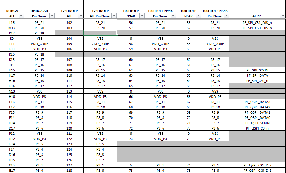

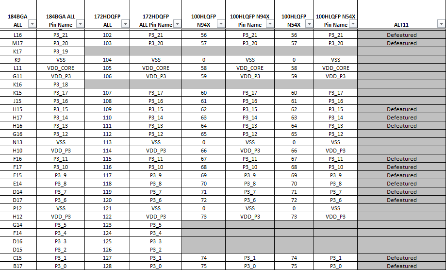

MCXNx4x Pinout xlsx Attachment Defeature PF* pins Erroneous pinouts to PF* signals on ALT11 are removed.
Before:
After:
