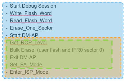

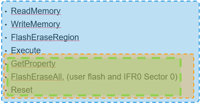

  • ISP commands supported in ROP0-ROP3:
  • SWD DM-AP commands supported in ROP0-ROP3:

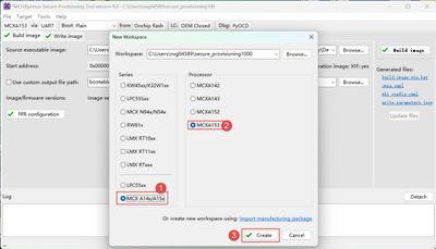

Step1. Create a new workspace
After opening the software, click File->New Workspace, select "MCX A14x/A15x" -> MCXA153 -> Click "create". Refer to the following figure:

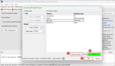

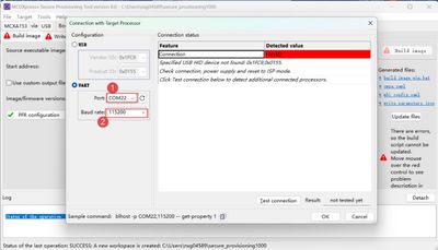

Step2. Connection with Target Processor
Enter ISP mode:Press and hold SW3(ISP key) => Press and release SW1 (RESET key) => Release SW3
Go to your workspace and click “Target”->Connection, the Connection with Target Processor window is displayed. Here, we make Connection through UART and select port and baud rate. Refer to the following figure:
We can click "Test connection" to check whether the connection is successful. If the connection is successful, the result will display "OK". We can also see the life cycle of the current board: OEM Open. Refer to the following figure:

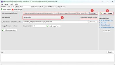

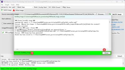

Step4. Build image
After completing the above operations, we need to load the .s19 or .hex file generated by MCUXpresso IDE into the Source executable image.
After the file is loaded, the start address is automatically identified. If the start address is not 0x00000000, you cannot "built image". Then click on "built image". Refer to the following figure:
After completing the built image, "SUCCECC: built image" will be displayed. Click "close". Refer to the following figure:

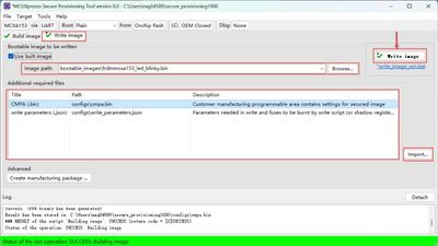

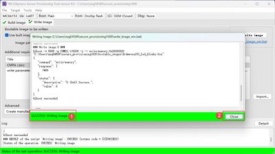

Step5. Write image
We can see that the required .bin file has been generated automatically in "write image", or we can import the corresponding .bin file we wrote by "import". The Image path file will be automatically loaded.

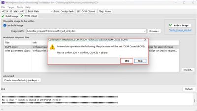

Clicking "write image" will pop up to confirm, and then click "ok" to run the script automatically. After the file is successfully written, the message "SUCCESS: write image" is displayed. Refer to the following figure:

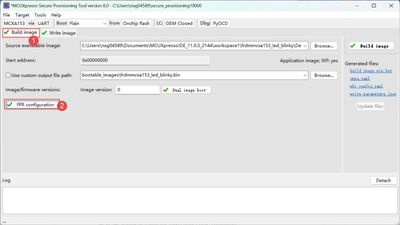

Step6. Check
When we complete the configuration of ROP 2, we can check the status of registers through "PFR configuration". The used registers cannot be read out and unknown is displayed, as shown in the following figure:
Finally, by pressing the RESET key on the board to exit ISP mode. At this point, the board has entered ROP 2, debug is disabled. The method of entering other ROP levels is the same.

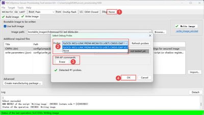

Next, we'll look at using the SWD bulk erase command.
Click on the toolbar "Dbg":
The Select Debug Probe window is displayed. Refer to the following figure:
Select “Probe: ”and click “erase”. After the erase succeeds, the following message is displayed: Flash mass erase succeeded! So we've successfully returned to ROP 0.
