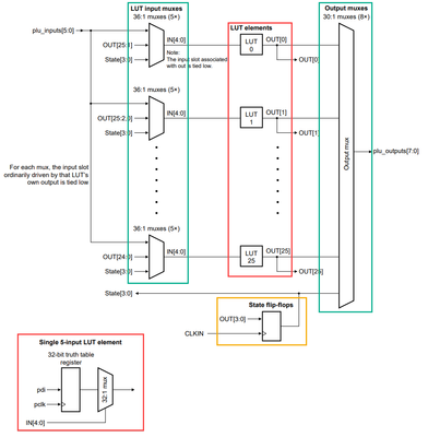

Module architecture
The PLU is composed of 3 main elements: Look Up Tables (LUTs), Multiplexers and Flip Flops. Look Up Tables are used to create the actual logic of the PLU’s network, while multiplexers route these logic signals to and from other LUTs, as well as the PLU’s input and output pins. Flip Flops provide a method of gating logic signals from LUT elements to a shared clock input, adding a mechanism of synchronization and delay to the logic network.
Look Up Table (LUT)
The PLU module has 26 inter-connectable Look Up Tables (LUTs), which can implement any combinational function with up to five inputs at once. The LUTs work by storing a pre-programmed output for every combination of inputs. This allows the look up tables to reproduce a specific output of logical 0 or 1 as soon as the input is changed without any processing required. By interconnecting LUT elements with one another, more complex programmable networks can be achieved, providing functionality of many logic gates at once.
Multiplexers
The PLU module includes a variety of multiplexers that select the inputs and outputs for each Look Up Table (LUT) element. Each LUT element has 5 input multiplexers that route a signal to each of its 5 inputs. The available input signals for each LUT include:
  • PLU Input pads.
  • Other LUT element outputs.
  • State Flip Flop outputs.

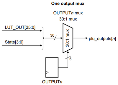

The PLU also has one output multiplexer for each PLU output pad (eight in total) that selects what Look-Up Table or Flip Flop state will drive each output pad.
Flip Flops
The final PLU element is a type D flip flop that allows for retention of data, providing the means for sequential logic circuits and simple state machines.
The PLU module has 4 flip flops that are connected to the outputs of LUTs[3:0] as well as the external PLU_CLKIN signal that is used for timing and synchronization between flip flops. In order to use the flip flop elements, a clock signal must be supplied via the PLU_CLKIN pad. Note that since the flip flops are directly connected to the outputs of the first 4 LUT elements, the corresponding LUT elements must be set up in order to use each Flip Flop element.

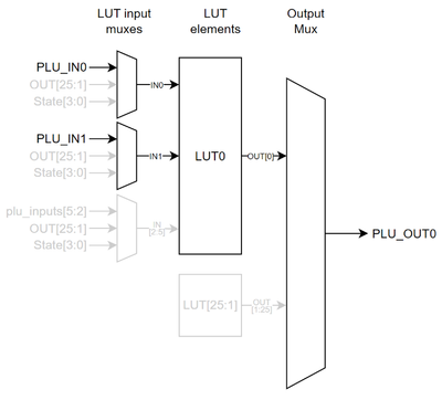

The previous tables show the register values to achieve all of the basic logic gates with the previous setup of LUT0. However, in order to achieve this configuration with input pins PLU_IN0 and PLU_IN1 as well as output pin PLU_OUT0, the multiplexers would have to be set up in the following manner:
In order to achieve this, pin PLU_IN0 must be routed as input[0] of LUT0 and PLU_IN1 as input[1] of LUT0. Additionally, the output of LUT0 will be routed to the PLU_OUT0 pad. This configuration to set up both input sources, route the output source and write the truth table register to result in an AND gate can be achieved with the following code:
/* Select input pin PLU_IN0 as LUT Input 0 (Input MUX0) for LUT0 on module PLU0 */
PLU_SetLutInputSource(PLU0, kPLU_LUT_0, kPLU_LUT_IN_0, kPLU_LUT_IN_SRC_PLU_IN_0);
/* Select input pin PLU_IN1 as LUT Input 1 (Input MUX1) for LUT0 on module PLU0 */
PLU_SetLutInputSource(PLU0, kPLU_LUT_0, kPLU_LUT_IN_1, kPLU_LUT_IN_SRC_PLU_IN_1);
/* Set Truth Table 0x08 for LUT element 0 on module PLU0 */
PLU_SetLutTruthTable(PLU0, kPLU_LUT_0, 0x08); // This will result in an AND gate
/* Select LUT0 output as driver for PLU_OUT0 pin on module PLU0 */
PLU_SetOutputSource(PLU0, kPLU_OUTPUT_0, kPLU_OUT_SRC_LUT_0);
