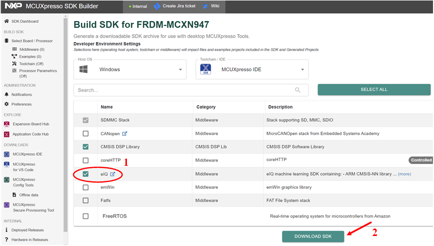

  • Generate and download FRDM-MCXN947 SDK package from the web-based MCUXpresso SDK builder.

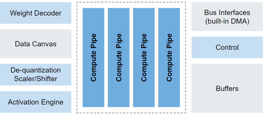

The eIQ Neutron NPUs offer support for a wide variety of neural network types such as CNN, RNN, TCN, and Transformer networks and more. ML application development with the eIQ Neutron NPU is fully supported by the eIQ machine learning software development environment. The NPU used in MCXN94 is Neutron N1-16, its block diagram is shown in the below figure.
The eIQ Neutron N1-16 NPU found inside the MCXN94 has 4 compute pipes and each compute pipe contains 4 INT8 MAC (Multiply Accumulate) blocks for a total of 16 MAC blocks. This means that MCXN94 could execute 4.8G(150MHz * 4 * 4 * 2) INT8 operations per second.

Download SDK and select FRDM-MCXN947 in MCUxpresso SDK Builder, Remember to select eIQ middleware.

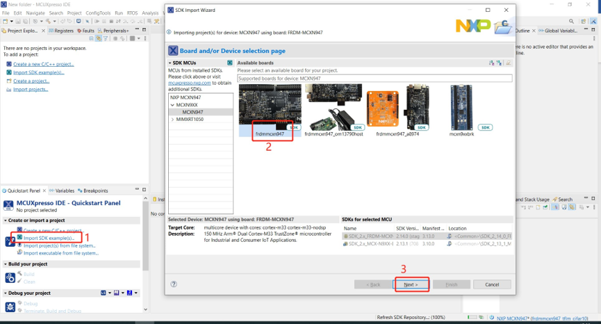

Then open MCUXpresso, it’s convenient to install the SDK by dragging and dropping the file into the SDK installation window of the MCUXpresso IDE.

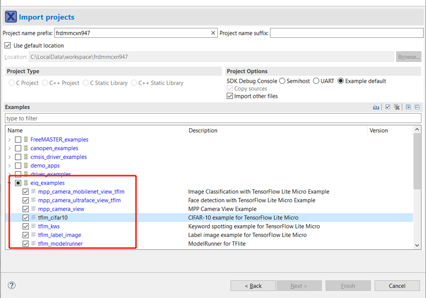

Import SDK examples into the workspace:
There are 7 ML examples included in SDK:tony_zhang_1-1705458421866.png
Here are the descriptions of the eIQ examples:
