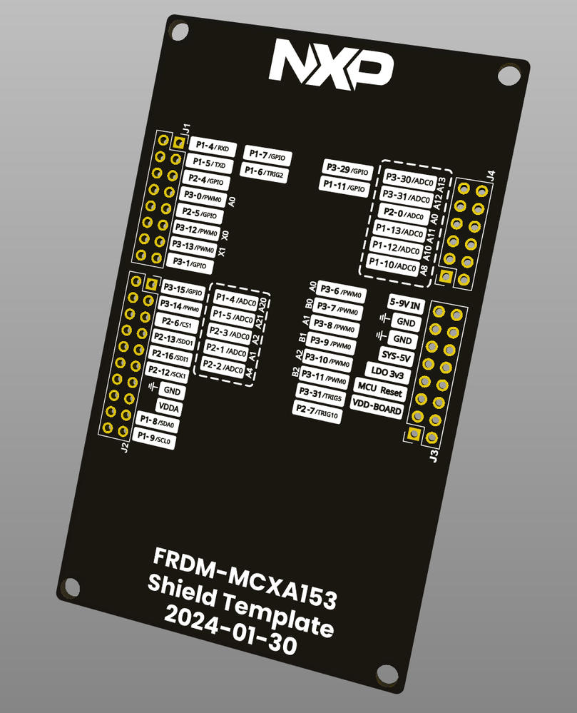

With the release of the FRDM-MCXA153 development board,   the community is offering an open-source PCB template for creating a custom "shield".   The shield template has a simple schematic with pin headers and netlabels to quickly identify the IO you need from the MCXA153. The PCB has the mechanical footprint to mate to the FRDM MCXA153 along with easy-to-read IO labels to get started.
The basics have been taken care of so you can quickly prototype a design with your own “secret” sauce using the high speed ADC, motor controller and I3C peripherals. Design files are available n the popular open-source KiCad and Altium Designer formats.
You can find the latest version on github:
https://github.com/wavenumber-eng/frdm-templates
