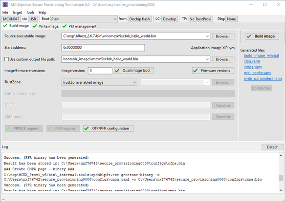

Security is at the core of NXP. Not only do we want each element of our devices or software to be safe and secure, but it is just as critical that we enable the manufacturing of each customer's product to be secure. Manufacturing processes should be worry-free and hassle-free with the backing of highly secure technology, even if the manufacturing site itself cannot provide strong assurances of security.
NXP is offers a variety of features that enable OEMs to protect their IP and revenue. Utilizing our MCUXpresso Secure Provisioning tool (SEC) and Secure Provisioning SDK (SPSDK)
MCXpresso Secure Provisioning tool (SEC)
The MCUXpresso Secure Provisioning tool (SEC) is a GUI-based application that provides firmware provisioning operations such as setting up e-fuses/OTP, building secure boot image, flash programming, keys generation, trust provisioning, etc.
NXP SEC tool features:
  • Easy-to-use configuration of secure provisioning project settings
  • Enables direct communication with attached device for provisioning and programming.
  • Supports generation of executable scripts for production use
  • Manufacturing mode for simplified production line use
Secure Provisioning SDK (SPSDK) is an open-source development kit with its source code released on Github and PyPI. It contains a set of API modules for custom production tool development which requires more advanced secure provisioning flow. SPSDK enables connection and communication with NXP’s microcontrollers for the following purposes:
