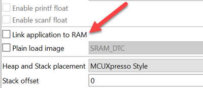

It seems a bit weird, maybe you can try to enable the below option, then give debug again.

Hi @jeremyzhou,
Many thanks for your answer.
No matter if the option is enabled or not, the behaviour is the same.
