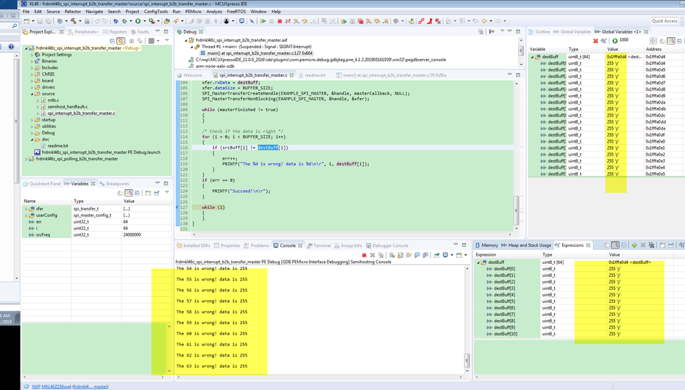

   This is the debug result and the printf result:
    You can find the the destBuff is wrong, the printf result is also wrong:   pastedImage_1.png
You can also give your test result if you connect nothing, just the master, whether your printf result is also ok? I can't believe it, please try it again.
Wish it helps you!
Kerry

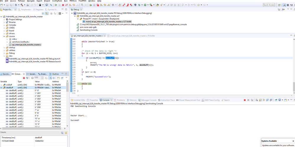

xdong
Kerry,
Thank you for the reply.
Above is the screenshot after the program is run. You may see the values in destBuff are same as srcBuff, and there is no error message. Thank you for your help.
